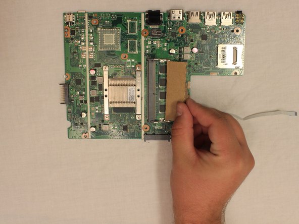

  8. Asus R541UA-RB51 Battery Replacement: crwdns2935265:08crwdnd2935265:01crwdnd2935265:03crwdne2935265:0 Asus R541UA-RB51 Battery Replacement: crwdns2935265:08crwdnd2935265:02crwdnd2935265:03crwdne2935265:0 Asus R541UA-RB51 Battery Replacement: crwdns2935265:08crwdnd2935265:03crwdnd2935265:03crwdne2935265:0
    • Unplug the three connections from the top of the motherboard.
    • Lift up at an angle to remove the motherboard from the computer. Take caution when lifting the areas where the USB ports are located. They are in small slots that exit the computer's main body. They will need to be slid through these slots to remove the motherboard.
  9. Asus R541UA-RB51 Battery Replacement: crwdns2935265:09crwdnd2935265:01crwdnd2935265:03crwdne2935265:0 Asus R541UA-RB51 Battery Replacement: crwdns2935265:09crwdnd2935265:02crwdnd2935265:03crwdne2935265:0 Asus R541UA-RB51 Battery Replacement: crwdns2935265:09crwdnd2935265:03crwdnd2935265:03crwdne2935265:0
    • Locate the RAM slot on the underside of the motherboard. This device did not have a RAM card so a piece of cardboard was used as a substitute.
    • Replace the current card with the new RAM card.
