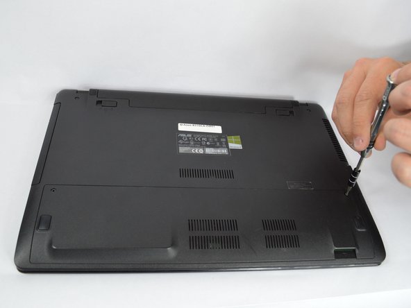

  6. Asus R510CA-OB01 Keyboard and Mousepad Replacement: crwdns2935265:06crwdnd2935265:01crwdnd2935265:02crwdne2935265:0 Asus R510CA-OB01 Keyboard and Mousepad Replacement: crwdns2935265:06crwdnd2935265:02crwdnd2935265:02crwdne2935265:0
    • Loosen the four 12mm screws on the bottom and top panel of your device using a Phillips #0 screwdriver.

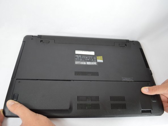

  7. Asus R510CA-OB01 Keyboard and Mousepad Replacement: crwdns2935265:07crwdnd2935265:01crwdnd2935265:03crwdne2935265:0 Asus R510CA-OB01 Keyboard and Mousepad Replacement: crwdns2935265:07crwdnd2935265:02crwdnd2935265:03crwdne2935265:0 Asus R510CA-OB01 Keyboard and Mousepad Replacement: crwdns2935265:07crwdnd2935265:03crwdnd2935265:03crwdne2935265:0
    • Use the grips to slide the panel off.
    • Remove the panel by lifting it off the device.

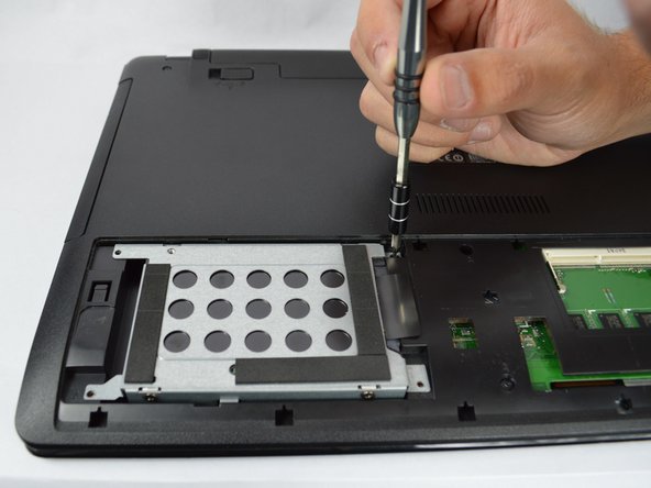

  8. Asus R510CA-OB01 Keyboard and Mousepad Replacement: crwdns2935265:08crwdnd2935265:01crwdnd2935265:02crwdne2935265:0 Asus R510CA-OB01 Keyboard and Mousepad Replacement: crwdns2935265:08crwdnd2935265:02crwdnd2935265:02crwdne2935265:0
    • Remove the three 5mm screws holding down the hard drive and the five 5mm screws holding down the casing using a Phillips #00 bit.

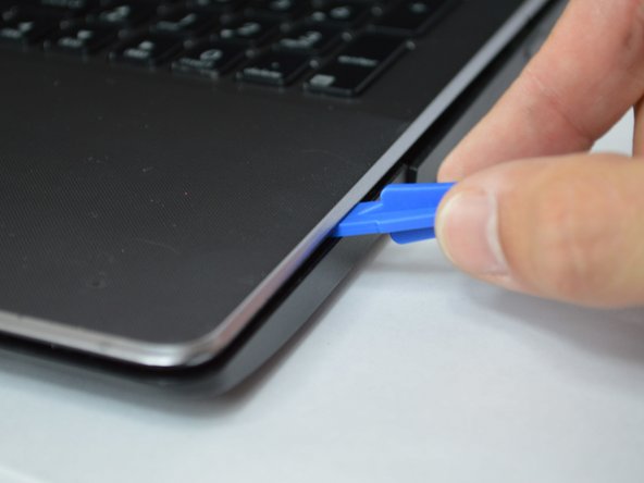

  9. Asus R510CA-OB01 Keyboard and Mousepad Replacement: crwdns2935265:09crwdnd2935265:01crwdnd2935265:02crwdne2935265:0 Asus R510CA-OB01 Keyboard and Mousepad Replacement: crwdns2935265:09crwdnd2935265:02crwdnd2935265:02crwdne2935265:0
    • Turn the laptop the right way up and face it towards you.
    • Insert the flat edge of the flat plastic opening tool into the crease of the keyboard cover.
    • While the opening tool is in the crease, carefully pry open the casing by sliding the plastic opening tool along the edge.

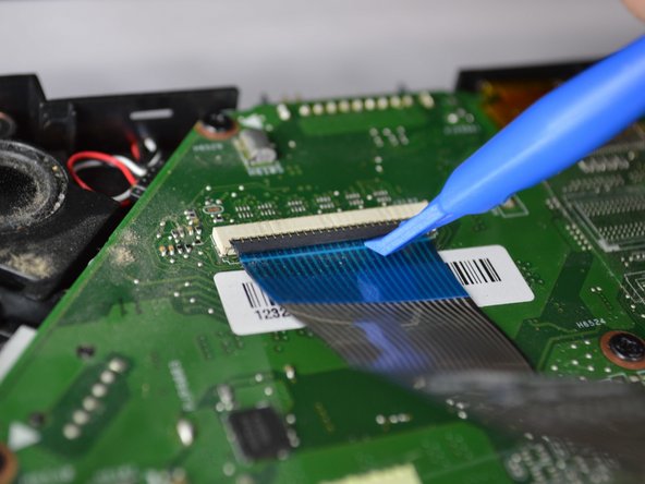

  11. Asus R510CA-OB01 Keyboard and Mousepad Replacement: crwdns2935265:011crwdnd2935265:01crwdnd2935265:03crwdne2935265:0 Asus R510CA-OB01 Keyboard and Mousepad Replacement: crwdns2935265:011crwdnd2935265:02crwdnd2935265:03crwdne2935265:0 Asus R510CA-OB01 Keyboard and Mousepad Replacement: crwdns2935265:011crwdnd2935265:03crwdnd2935265:03crwdne2935265:0
    • Remove each data cable from the motherboard by using your finger or the plastic opening tool to lift the white latch.
    • The cable will slide out of its place.
