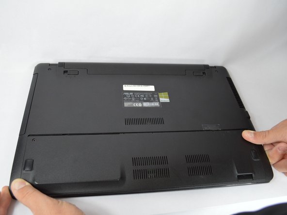

    • Shut down the computer and disconnect all external devices connected to it.
    • Turn the computer so that it is upside down. Position the computer with the front towards you.
  2. Asus R510CA-OB01 Hard Drive Replacement: crwdns2935265:02crwdnd2935265:01crwdnd2935265:02crwdne2935265:0 Asus R510CA-OB01 Hard Drive Replacement: crwdns2935265:02crwdnd2935265:02crwdnd2935265:02crwdne2935265:0

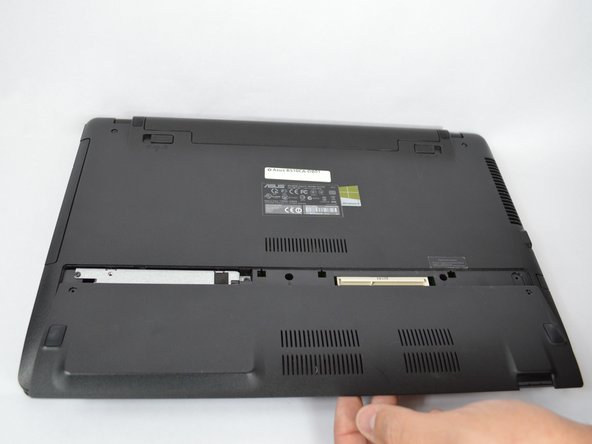

    • Loosen the two 12 mm screws on the bottom panel of your device using a Phillips size 0 bit.
  3. Asus R510CA-OB01 Hard Drive Replacement: crwdns2935265:03crwdnd2935265:01crwdnd2935265:03crwdne2935265:0 Asus R510CA-OB01 Hard Drive Replacement: crwdns2935265:03crwdnd2935265:02crwdnd2935265:03crwdne2935265:0 Asus R510CA-OB01 Hard Drive Replacement: crwdns2935265:03crwdnd2935265:03crwdnd2935265:03crwdne2935265:0
    • Use the grips to slide the panel off.
    • Remove the panel by lifting it off the device.

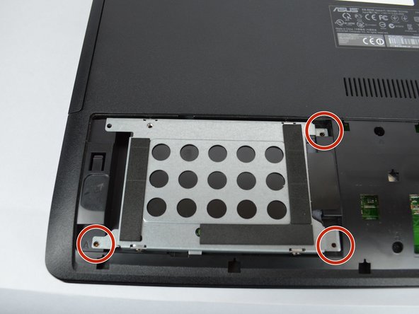

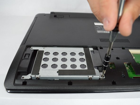

    • Loosen the three 5 mm screws holding down the hard drive using a Phillips #00 bit.
  5. Asus R510CA-OB01 Hard Drive Replacement: crwdns2935265:05crwdnd2935265:01crwdnd2935265:02crwdne2935265:0 Asus R510CA-OB01 Hard Drive Replacement: crwdns2935265:05crwdnd2935265:02crwdnd2935265:02crwdne2935265:0
    • Slide the casing (hard drive bay) for the hard drive to the left.
    • Lift it to remove it from the device.
