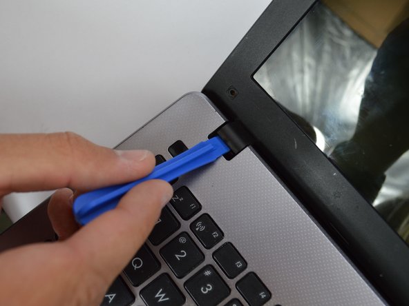

      • Open the device.
      • Remove the black plastic squares on each side with a spudger.

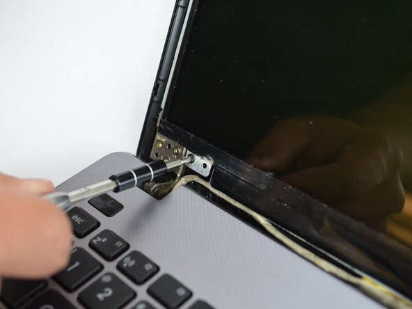

    2. Asus R510CA-OB01 Display Replacement: crwdns2935265:02crwdnd2935265:01crwdnd2935265:02crwdne2935265:0 Asus R510CA-OB01 Display Replacement: crwdns2935265:02crwdnd2935265:02crwdnd2935265:02crwdne2935265:0
      • Remove the two 5mm screws at each bottom corner of the display using a Phillips #0 screwdriver.

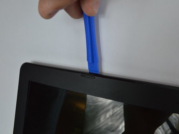

    3. Asus R510CA-OB01 Display Replacement: crwdns2935265:03crwdnd2935265:01crwdnd2935265:03crwdne2935265:0 Asus R510CA-OB01 Display Replacement: crwdns2935265:03crwdnd2935265:02crwdnd2935265:03crwdne2935265:0 Asus R510CA-OB01 Display Replacement: crwdns2935265:03crwdnd2935265:03crwdnd2935265:03crwdne2935265:0
      • After the two screws are removed, use a plastic opening tool to remove the black cover around the screen.

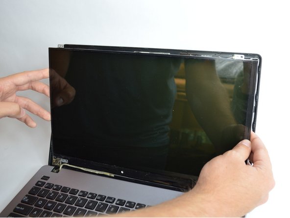

    4. Asus R510CA-OB01 Display Replacement: crwdns2935265:04crwdnd2935265:01crwdnd2935265:03crwdne2935265:0 Asus R510CA-OB01 Display Replacement: crwdns2935265:04crwdnd2935265:02crwdnd2935265:03crwdne2935265:0 Asus R510CA-OB01 Display Replacement: crwdns2935265:04crwdnd2935265:03crwdnd2935265:03crwdne2935265:0
      • Remove the four 5mm screws that attach the screen with a Philips #0 screwdriver.

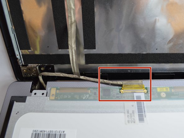

    5. Asus R510CA-OB01 Display Replacement: crwdns2935265:05crwdnd2935265:01crwdnd2935265:02crwdne2935265:0 Asus R510CA-OB01 Display Replacement: crwdns2935265:05crwdnd2935265:02crwdnd2935265:02crwdne2935265:0
      • Lift up the screen from the back of the laptop and then you will see a cable connected to the screen.
      • You can simply disconnect the cable and insert a new screen.
