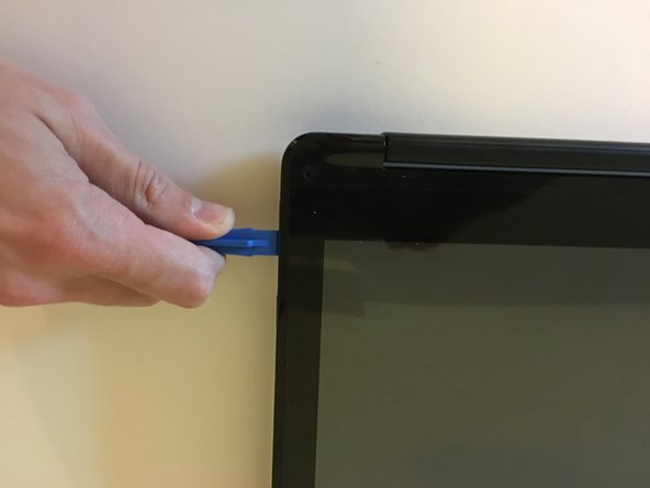

    • Wedge an opening tool between the two halves of the screen.
    • Keep the two latches together and go completely around the screen to release all the latches.
  4. Asus Q552UB-BHI7T12 Screen Replacement: crwdns2935265:04crwdnd2935265:01crwdnd2935265:02crwdne2935265:0 Asus Q552UB-BHI7T12 Screen Replacement: crwdns2935265:04crwdnd2935265:02crwdnd2935265:02crwdne2935265:0
    • Separate the two parts of the screen.

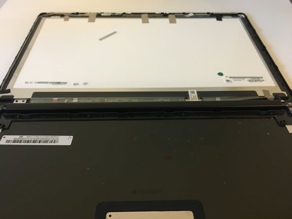

  5. Asus Q552UB-BHI7T12 Screen Replacement: crwdns2935265:05crwdnd2935265:01crwdnd2935265:01crwdne2935265:0
    • Remove any tape that is holding the screen in place.

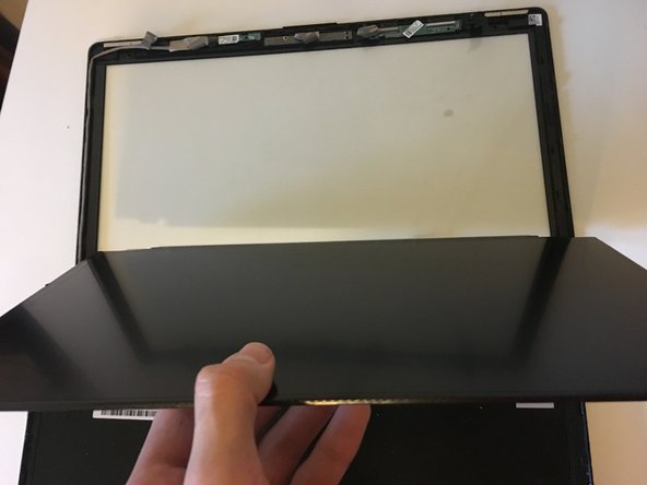

  6. Asus Q552UB-BHI7T12 Screen Replacement: crwdns2935265:06crwdnd2935265:01crwdnd2935265:02crwdne2935265:0 Asus Q552UB-BHI7T12 Screen Replacement: crwdns2935265:06crwdnd2935265:02crwdnd2935265:02crwdne2935265:0
    • Use an opening tool to lift out the screen after all the tape is removed.
    • The screen may be stuck due to any tape or any remaining glue.
  7. Asus Q552UB-BHI7T12 Screen Replacement: crwdns2935265:07crwdnd2935265:01crwdnd2935265:01crwdne2935265:0
    • Pull the screen horizontally away to remove the last cable attached to the screen.
