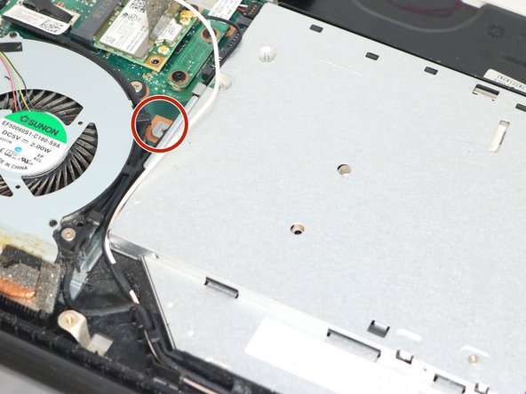

  5. Asus Q551L Repair Motherboard Replacement, Optical Drive (PN UJ8E2): crwdns2935265:05crwdnd2935265:01crwdnd2935265:03crwdne2935265:0 Asus Q551L Repair Motherboard Replacement, Optical Drive (PN UJ8E2): crwdns2935265:05crwdnd2935265:02crwdnd2935265:03crwdne2935265:0 Asus Q551L Repair Motherboard Replacement, Optical Drive (PN UJ8E2): crwdns2935265:05crwdnd2935265:03crwdnd2935265:03crwdne2935265:0
    • Lift up the sticker that sticks between the motherboard and the optical drive. Then, unscrew the one screw where it is marked and slide it out gently.
    • Watch out for the wires around the optical drive.

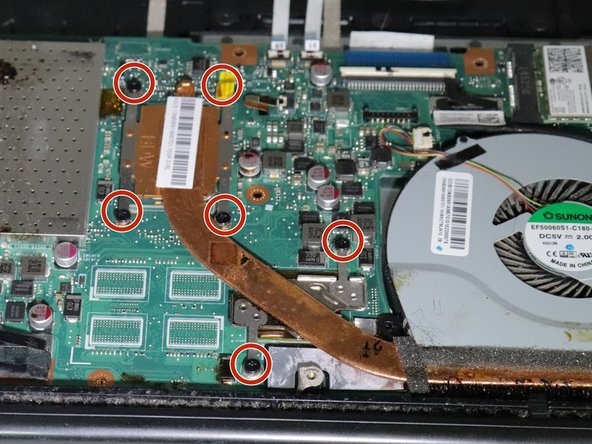

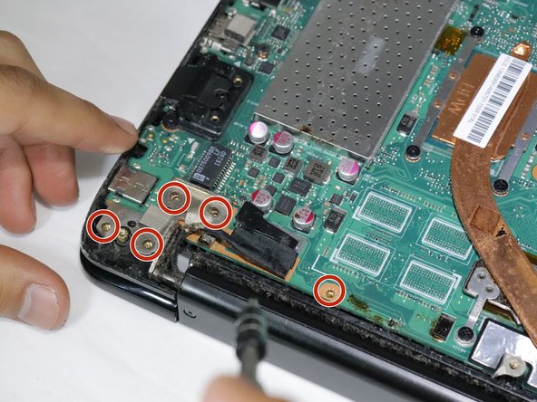

  6. Asus Q551L Repair Motherboard Replacement, Motherboard: crwdns2935265:06crwdnd2935265:01crwdnd2935265:03crwdne2935265:0 Asus Q551L Repair Motherboard Replacement, Motherboard: crwdns2935265:06crwdnd2935265:02crwdnd2935265:03crwdne2935265:0 Asus Q551L Repair Motherboard Replacement, Motherboard: crwdns2935265:06crwdnd2935265:03crwdnd2935265:03crwdne2935265:0
    • Remove the fan by unscrewing the nine screws shown in the images.
    • The four colored wire and the black cable need to be pulled out gently.
    • There will be wires around the fan. Make sure they are not stuck to it.
    • You want to keep the fan if it still in good conditions.
  7. Asus Q551L Repair Motherboard Replacement: crwdns2935265:07crwdnd2935265:01crwdnd2935265:02crwdne2935265:0 Asus Q551L Repair Motherboard Replacement: crwdns2935265:07crwdnd2935265:02crwdnd2935265:02crwdne2935265:0
    • Unscrew the seven screws Phillips Head 0.0793 MM on the edges of the motherboard.

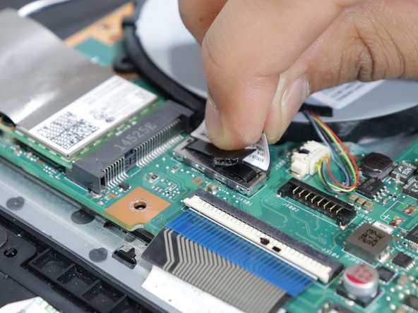

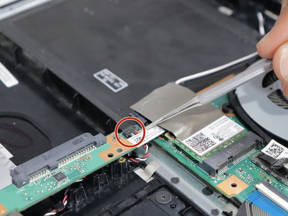

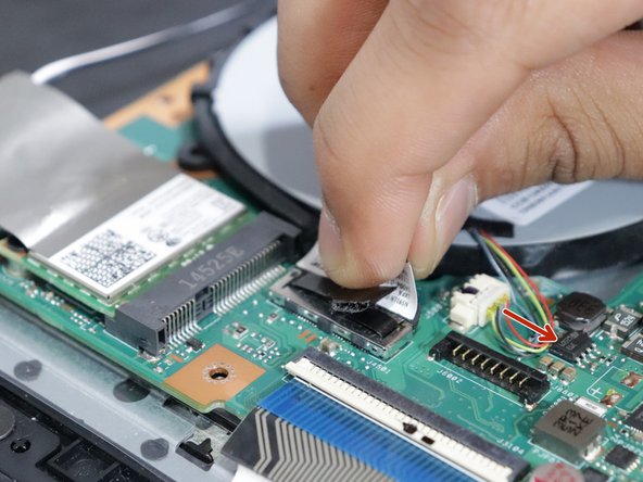

  8. Asus Q551L Repair Motherboard Replacement: crwdns2935265:08crwdnd2935265:01crwdnd2935265:03crwdne2935265:0 Asus Q551L Repair Motherboard Replacement: crwdns2935265:08crwdnd2935265:02crwdnd2935265:03crwdne2935265:0 Asus Q551L Repair Motherboard Replacement: crwdns2935265:08crwdnd2935265:03crwdnd2935265:03crwdne2935265:0
    • Disconnect any cables that hold the motherboard.
    • Open up the white adjustable latch first to pull out the tapes.
