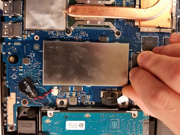

  5. Asus Q534U RAM Replacement, RAM: crwdns2935265:05crwdnd2935265:01crwdnd2935265:03crwdne2935265:0 Asus Q534U RAM Replacement, RAM: crwdns2935265:05crwdnd2935265:02crwdnd2935265:03crwdne2935265:0 Asus Q534U RAM Replacement, RAM: crwdns2935265:05crwdnd2935265:03crwdnd2935265:03crwdne2935265:0
    • Locate the metal RAM cover
    • Pull the metal tab on the corner of the metal cover to lift the cover from its clips
    • A pry tool may provide a better grip on small tab.
  6. Asus Q534U RAM Replacement: crwdns2935265:06crwdnd2935265:01crwdnd2935265:03crwdne2935265:0 Asus Q534U RAM Replacement: crwdns2935265:06crwdnd2935265:02crwdnd2935265:03crwdne2935265:0 Asus Q534U RAM Replacement: crwdns2935265:06crwdnd2935265:03crwdnd2935265:03crwdne2935265:0
    • While pushing out the metal clips on both sides of the RAM, lift up the RAM to release it
    • Pull the RAM out gently and bring it up from the slot
    • Make sure to pull out first and then pull the RAM up out of place

One question: I have this model and have determined that I have a bad stick of RAM. I have removed this stick but still have 8 gigs available. Is there another stick that I m not seeing or is this built in?
Elijah Elliott - crwdns2934203:0crwdne2934203:0 crwdns2950251:0crwdne2950251:0
saame here must be another stick somewhere
SvGGRK - crwdns2934203:0crwdne2934203:0 crwdns2950251:0crwdne2950251:0
There are 4, 2GB chips of ram, hard built into the motherboard. Located right above the SSD m.2 bay, and beside the copper cooling line. This model of Laptop has one RAM bay, I'm not sure how the Built in and Bay RAM work together but for all intents and purposes, just assume you are only using the Bay for RAM. @svggrk @elijahelliott
