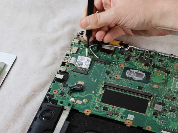

  5. Asus Q525U Wi-Fi Card Replacement: crwdns2935265:05crwdnd2935265:01crwdnd2935265:01crwdne2935265:0
    • Use a pair of pointed tweezers to disconnect the small black and white coaxial connectors from the Wi-Fi card.

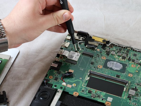

  6. Asus Q525U Wi-Fi Card Replacement: crwdns2935265:06crwdnd2935265:01crwdnd2935265:02crwdne2935265:0 Asus Q525U Wi-Fi Card Replacement: crwdns2935265:06crwdnd2935265:02crwdnd2935265:02crwdne2935265:0
    • Use the pointed tweezers to pull the network card out and away from the socket.
