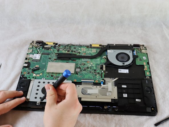

    1. Asus Q525U Hard Drive Replacement, Hard Drive: crwdns2935265:04crwdnd2935265:01crwdnd2935265:01crwdne2935265:0
      • The hard drive is located to the left of the battery and below the motherboard.
    2. Asus Q525U Hard Drive Replacement: crwdns2935265:05crwdnd2935265:01crwdnd2935265:02crwdne2935265:0 Asus Q525U Hard Drive Replacement: crwdns2935265:05crwdnd2935265:02crwdnd2935265:02crwdne2935265:0
      • Remove the two 4 mm Phillips #1 screws which are holding the hard drive cover in place.
    3. Asus Q525U Hard Drive Replacement: crwdns2935265:06crwdnd2935265:01crwdnd2935265:02crwdne2935265:0 Asus Q525U Hard Drive Replacement: crwdns2935265:06crwdnd2935265:02crwdnd2935265:02crwdne2935265:0
      • The hard drive cover is now easily accessible.
      • Lift the cover off, exposing the hard drive underneath [this laptop is missing its hard drive].
      • If replacing the hard drive, lift it up on the right side slightly and pull it from the connecter on the left.
