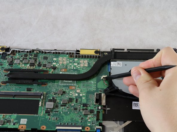

    • Use the Halberd spudger to carefully disconnect the bundled slide connector that connects the CPU fan to the motherboard.
    • To disconnect it safely, use the pointed tip of a spudger to carefully push on each side of the connector.

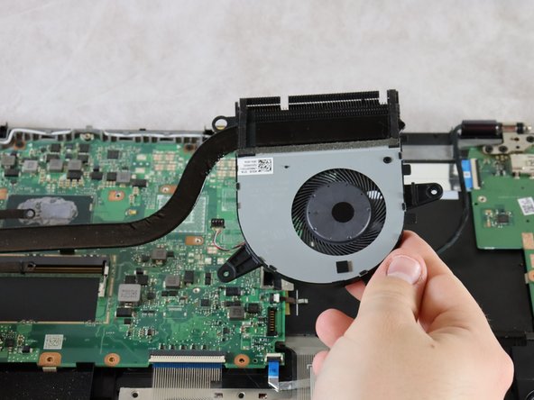

    • Carefully remove the thicker black cord from the cord clips surrounding the fan.
    • Remove the fan from the device.
