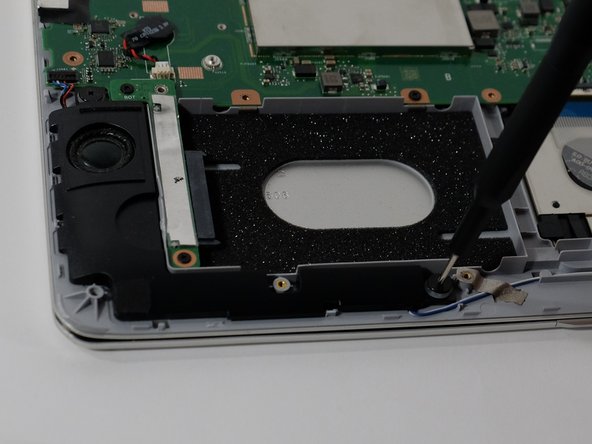

    • After locating the right speaker, use a Phillips #1 screwdriver to remove both 5 mm screws from either side of the speaker.
  6. Asus Q505UA-BI5T7 Speaker Replacement: crwdns2935265:06crwdnd2935265:01crwdnd2935265:02crwdne2935265:0 Asus Q505UA-BI5T7 Speaker Replacement: crwdns2935265:06crwdnd2935265:02crwdnd2935265:02crwdne2935265:0

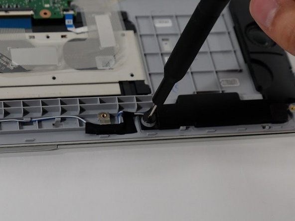

    • After locating the left speaker by the hard drive, use a Phillips #1 screwdriver to remove both 5 mm screws from either side of the speaker.

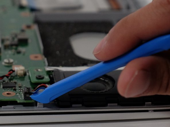

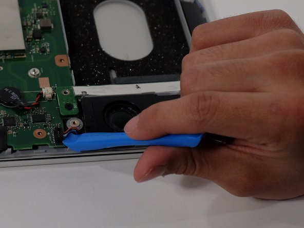

    • Using the blue ifixit Opening Tool, gently pry the connection panel from its place.
