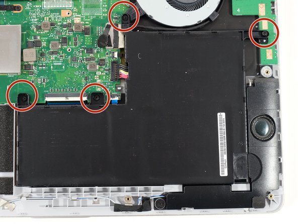

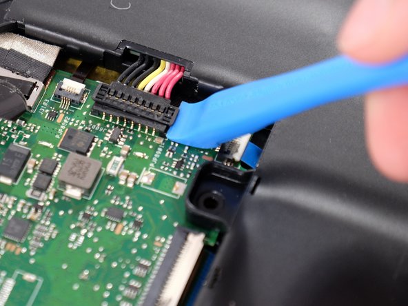

  4. Asus Q505UA-BI5T7 Screen Replacement, Battery: crwdns2935265:04crwdnd2935265:01crwdnd2935265:02crwdne2935265:0 Asus Q505UA-BI5T7 Screen Replacement, Battery: crwdns2935265:04crwdnd2935265:02crwdnd2935265:02crwdne2935265:0
    • Make sure your device is turned off. Remove the 5 mm screws on each respective side of the battery by twisting counter-clockwise with a #0 Phillips screwdriver.

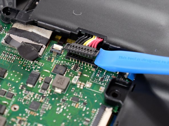

  5. Asus Q505UA-BI5T7 Screen Replacement: crwdns2935265:05crwdnd2935265:01crwdnd2935265:03crwdne2935265:0 Asus Q505UA-BI5T7 Screen Replacement: crwdns2935265:05crwdnd2935265:02crwdnd2935265:03crwdne2935265:0 Asus Q505UA-BI5T7 Screen Replacement: crwdns2935265:05crwdnd2935265:03crwdnd2935265:03crwdne2935265:0
    • Use a plastic opening tool to gently pry off the connected panel.
  6. Asus Q505UA-BI5T7 Screen Replacement: crwdns2935265:06crwdnd2935265:01crwdnd2935265:01crwdne2935265:0
    • Gently lift the battery.

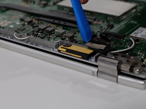

  7. Asus Q505UA-BI5T7 Screen Replacement, Screen: crwdns2935265:07crwdnd2935265:01crwdnd2935265:03crwdne2935265:0 Asus Q505UA-BI5T7 Screen Replacement, Screen: crwdns2935265:07crwdnd2935265:02crwdnd2935265:03crwdne2935265:0 Asus Q505UA-BI5T7 Screen Replacement, Screen: crwdns2935265:07crwdnd2935265:03crwdnd2935265:03crwdne2935265:0
    • After following the battery removal guide, use your Ifixit opening tool to pry the two screen connectors off of the laptop motherboard.
    • The screen connector next to the fan must be unwrapped from around the fan so it is free

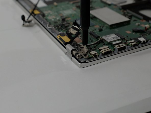

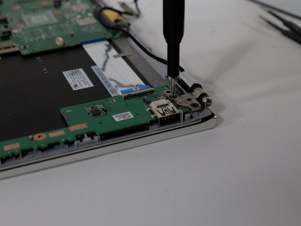

    • Use a Phillips #0 screwdriver to remove the three 5 mm screws securing each hinge on the laptop.

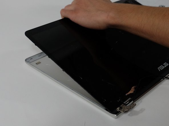

  9. Asus Q505UA-BI5T7 Screen Replacement: crwdns2935265:09crwdnd2935265:01crwdnd2935265:01crwdne2935265:0
    • Then, gently open the screen a bit and remove the screen from the hinges, being careful with the screen connectors.

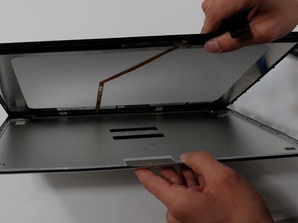

    • After removing the screen from the laptop, use a metal pry tool to get within the gap of the screen and the casing.
    • Go all around the screen with the pry tool and detach and lift the screen from the casing.

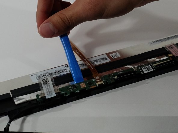

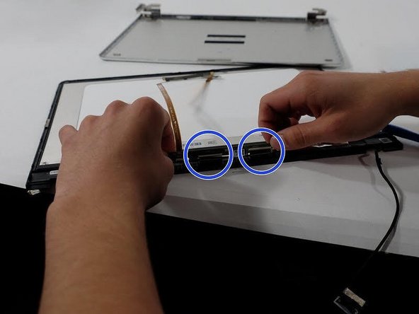

  11. Asus Q505UA-BI5T7 Screen Replacement: crwdns2935265:011crwdnd2935265:01crwdnd2935265:03crwdne2935265:0 Asus Q505UA-BI5T7 Screen Replacement: crwdns2935265:011crwdnd2935265:02crwdnd2935265:03crwdne2935265:0 Asus Q505UA-BI5T7 Screen Replacement: crwdns2935265:011crwdnd2935265:03crwdnd2935265:03crwdne2935265:0
    • Using your Ifixit opening tool, remove the camera stuck on with an adhesive strip off of the top of the screen.
    • Using the same tool, pry and unclip the bottom touchscreen module from the screen.
    • Before removing the module from the screen, unclip the two ribbon cables still keeping it tethered.
    • Be sure to be careful with the ribbon cables so as to not tear them.
    • You can now remove the touchscreen module connected to the camera from the old screen and transfer it to your new one.
