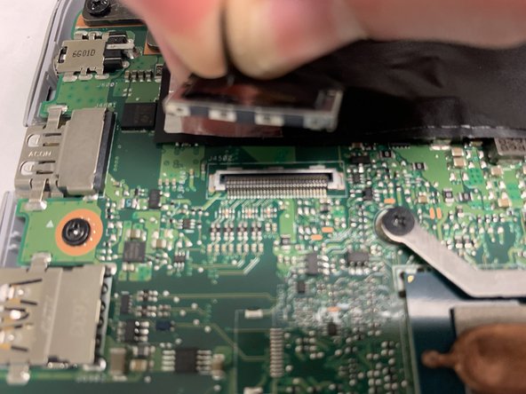

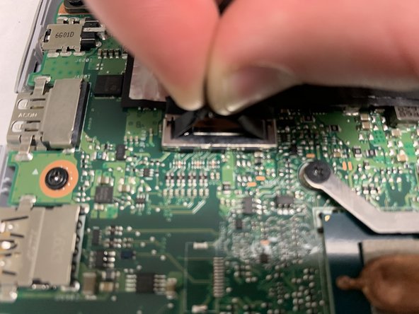

  7. Asus Q504UA-BHI5T13 Display Assembly Replacement: crwdns2935265:07crwdnd2935265:01crwdnd2935265:03crwdne2935265:0 Asus Q504UA-BHI5T13 Display Assembly Replacement: crwdns2935265:07crwdnd2935265:02crwdnd2935265:03crwdne2935265:0 Asus Q504UA-BHI5T13 Display Assembly Replacement: crwdns2935265:07crwdnd2935265:03crwdnd2935265:03crwdne2935265:0
    • Remove the two connectors with your hands, as shown.

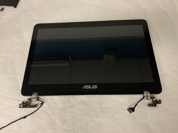

  8. Asus Q504UA-BHI5T13 Display Assembly Replacement: crwdns2935265:08crwdnd2935265:01crwdnd2935265:02crwdne2935265:0 Asus Q504UA-BHI5T13 Display Assembly Replacement: crwdns2935265:08crwdnd2935265:02crwdnd2935265:02crwdne2935265:0
    • Hold the display assembly with two hands and pull upwards to remove.
