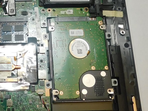

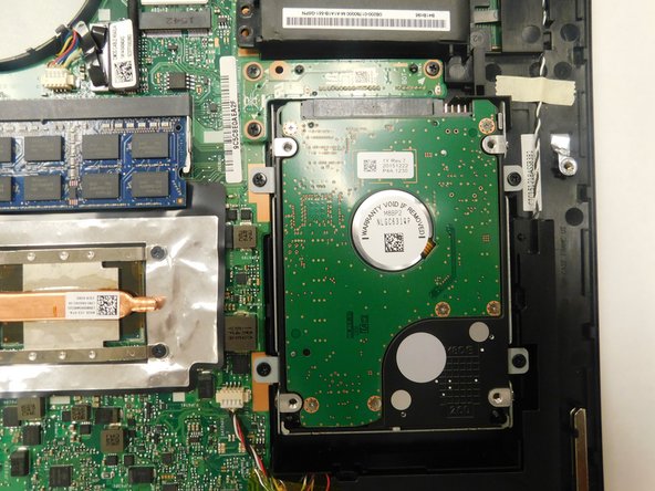

  7. Asus Q503UA-BSI5T17 Hard Drive Removal, Hard Drive: crwdns2935265:07crwdnd2935265:01crwdnd2935265:02crwdne2935265:0 Asus Q503UA-BSI5T17 Hard Drive Removal, Hard Drive: crwdns2935265:07crwdnd2935265:02crwdnd2935265:02crwdne2935265:0
    • Once you opened the laptop, the hard drive is located on the bottom right from where the battery is.
  8. Asus Q503UA-BSI5T17 Hard Drive Removal: crwdns2935265:08crwdnd2935265:01crwdnd2935265:02crwdne2935265:0 Asus Q503UA-BSI5T17 Hard Drive Removal: crwdns2935265:08crwdnd2935265:02crwdnd2935265:02crwdne2935265:0
    • Use a Phillips #0 screwdriver to unscrew the four screws surrounding the hard drive.
  9. Asus Q503UA-BSI5T17 Hard Drive Removal: crwdns2935265:09crwdnd2935265:01crwdnd2935265:02crwdne2935265:0 Asus Q503UA-BSI5T17 Hard Drive Removal: crwdns2935265:09crwdnd2935265:02crwdnd2935265:02crwdne2935265:0
    • Disconnect the cable that is connected to the hard drive by lifting the edge slightly and sliding it horizontally away from the connector.
    • Remove the hard drive.
    • You may need to further remove the metal mounting brackets from your old hard drive then install them on your new hard drive before reinstallation.
