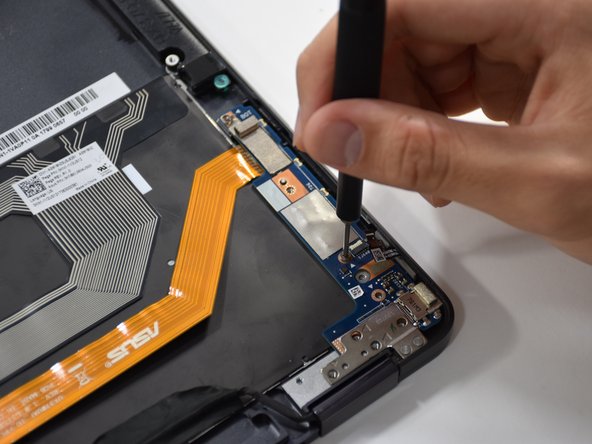

    • Remove the four 4.8 mm screws using a Phillips #00 screwdriver.

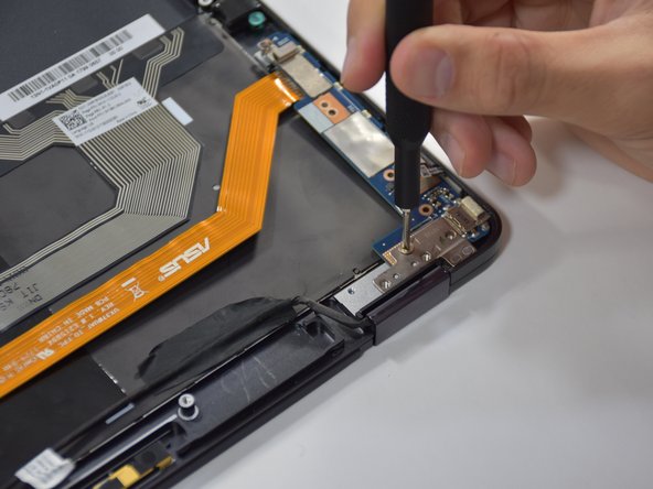

  23. Asus Q325U Keyboard Replacement: crwdns2935265:023crwdnd2935265:01crwdnd2935265:02crwdne2935265:0 Asus Q325U Keyboard Replacement: crwdns2935265:023crwdnd2935265:02crwdnd2935265:02crwdne2935265:0
    • Slightly open up the laptop. This will lift up the hinge at the corner and free the motherboard.

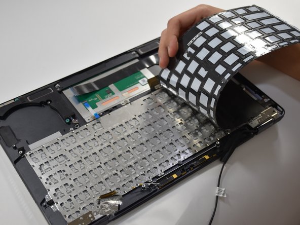

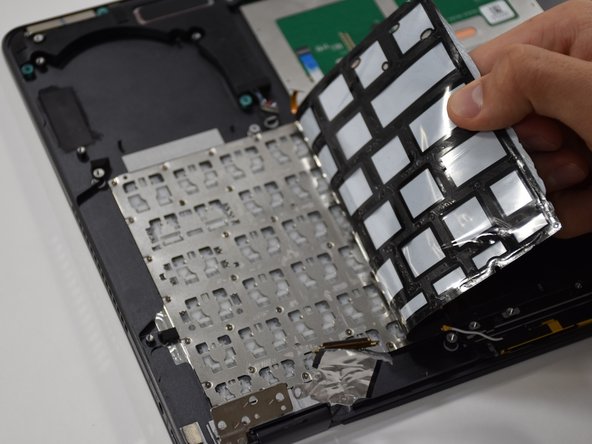

    • Starting at the upper left corner, remove the black adhesive from the keyboard.
  30. Asus Q325U Keyboard Replacement: crwdns2935265:030crwdnd2935265:01crwdnd2935265:02crwdne2935265:0 Asus Q325U Keyboard Replacement: crwdns2935265:030crwdnd2935265:02crwdnd2935265:02crwdne2935265:0

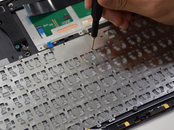

    • Remove eighty 1 mm screws located on the keyboard frame using a Phillips #000 screwdriver.
  31. Asus Q325U Keyboard Replacement: crwdns2935265:031crwdnd2935265:01crwdnd2935265:01crwdne2935265:0
    • Grab the edge of the keyboard and lift upwards to remove.
