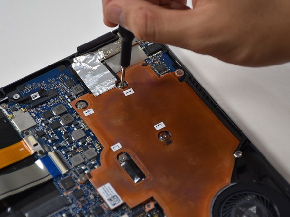

  3. Asus Q325U CPU Fan Replacement, Copper Plate: crwdns2935265:03crwdnd2935265:01crwdnd2935265:02crwdne2935265:0 Asus Q325U CPU Fan Replacement, Copper Plate: crwdns2935265:03crwdnd2935265:02crwdnd2935265:02crwdne2935265:0
    • Remove the six 3mm screws using a Phillips #00.

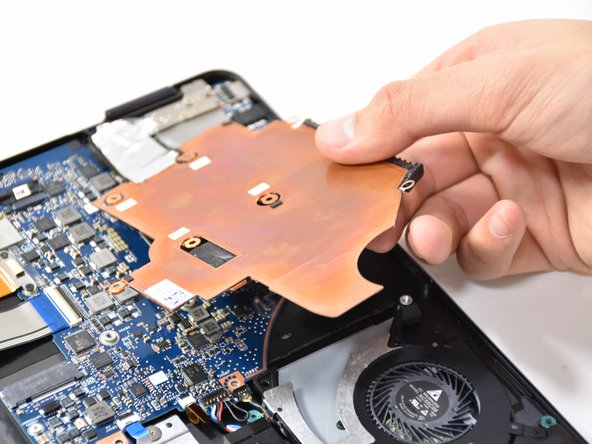

  4. Asus Q325U CPU Fan Replacement: crwdns2935265:04crwdnd2935265:01crwdnd2935265:02crwdne2935265:0 Asus Q325U CPU Fan Replacement: crwdns2935265:04crwdnd2935265:02crwdnd2935265:02crwdne2935265:0
    • Use the plastic opening tool to lift up the edge. Pull upward on the edge.

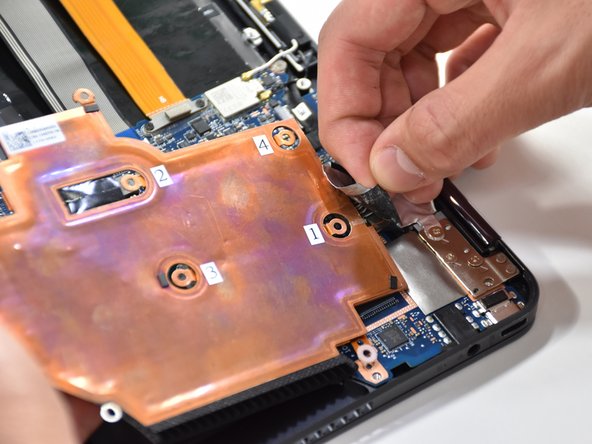

  5. Asus Q325U CPU Fan Replacement: crwdns2935265:05crwdnd2935265:01crwdnd2935265:02crwdne2935265:0 Asus Q325U CPU Fan Replacement: crwdns2935265:05crwdnd2935265:02crwdnd2935265:02crwdne2935265:0
    • On the other side of the plate, remove the tape.

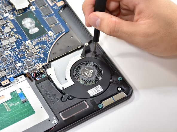

  6. Asus Q325U CPU Fan Replacement, CPU Fan: crwdns2935265:06crwdnd2935265:01crwdnd2935265:02crwdne2935265:0 Asus Q325U CPU Fan Replacement, CPU Fan: crwdns2935265:06crwdnd2935265:02crwdnd2935265:02crwdne2935265:0
    • Remove the three 3.7 mm screws using a Phillips #00 screwdriver.
  7. Asus Q325U CPU Fan Replacement: crwdns2935265:07crwdnd2935265:01crwdnd2935265:01crwdne2935265:0
    • Detach the black wire and plug shown using a tweezer.
  8. Asus Q325U CPU Fan Replacement: crwdns2935265:08crwdnd2935265:01crwdnd2935265:01crwdne2935265:0
    • Grab CPU fan by its edge and gently pull upwards to remove.
