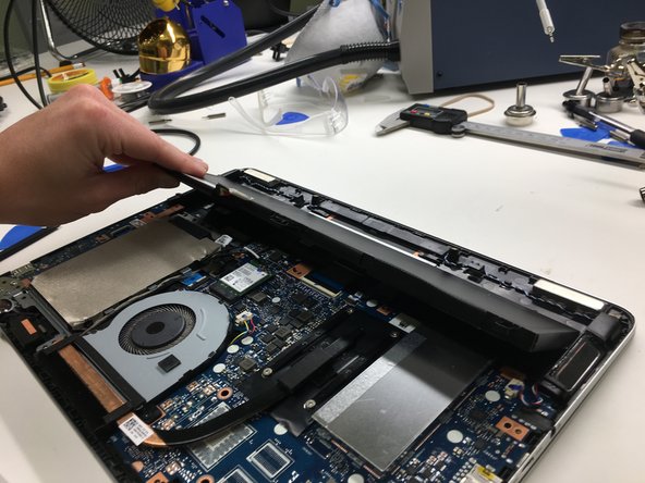

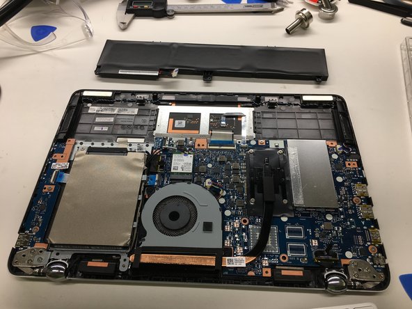

  4. Asus Q304UA Motherboard Replacement, Remove the battery: crwdns2935265:04crwdnd2935265:01crwdnd2935265:01crwdne2935265:0
    • Remove the Phillips #0 screws that secure the battery to the lower case assembly
    • Three 4.7 mm screws.
  5. Asus Q304UA Motherboard Replacement: crwdns2935265:05crwdnd2935265:01crwdnd2935265:03crwdne2935265:0 Asus Q304UA Motherboard Replacement: crwdns2935265:05crwdnd2935265:02crwdnd2935265:03crwdne2935265:0 Asus Q304UA Motherboard Replacement: crwdns2935265:05crwdnd2935265:03crwdnd2935265:03crwdne2935265:0
    • Tilt battery up from the side closest to the motherboard
    • Pull the battery out of the chassis away from the two plastic retainers near the front of the laptop.

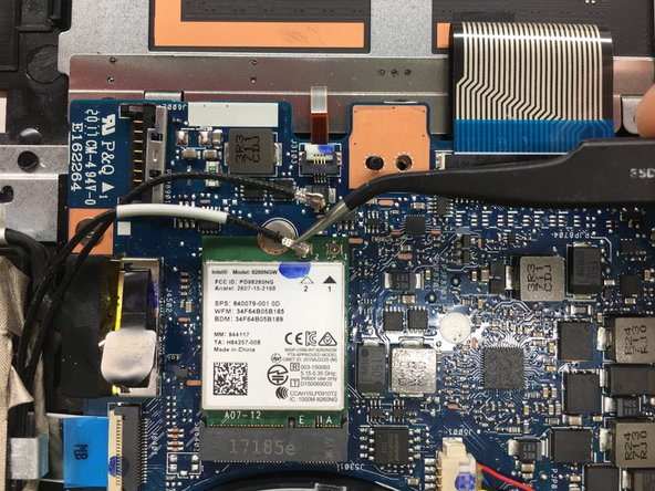

  6. Asus Q304UA Motherboard Replacement, Disconnect RF cables: crwdns2935265:06crwdnd2935265:01crwdnd2935265:03crwdne2935265:0 Asus Q304UA Motherboard Replacement, Disconnect RF cables: crwdns2935265:06crwdnd2935265:02crwdnd2935265:03crwdne2935265:0 Asus Q304UA Motherboard Replacement, Disconnect RF cables: crwdns2935265:06crwdnd2935265:03crwdnd2935265:03crwdne2935265:0
    • Disconnect the Wifi/Bluetooth RF cables from the wireless card.
    • Pull the RF cables by the metal connector, not by the rubber shielding. This avoids damaging the connector and the cable.

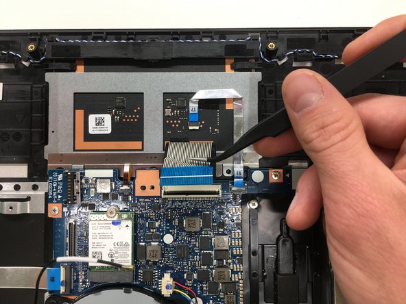

  14. Asus Q304UA Motherboard Replacement: crwdns2935265:014crwdnd2935265:01crwdnd2935265:03crwdne2935265:0 Asus Q304UA Motherboard Replacement: crwdns2935265:014crwdnd2935265:02crwdnd2935265:03crwdne2935265:0 Asus Q304UA Motherboard Replacement: crwdns2935265:014crwdnd2935265:03crwdnd2935265:03crwdne2935265:0
    • Use a spudger to flip up the retaining flap on the trackpad ribbon cable ZIP socket.
    • Use tweezers to pull the ribbon cable straight out of the ZIF socket.

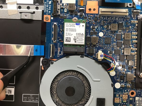

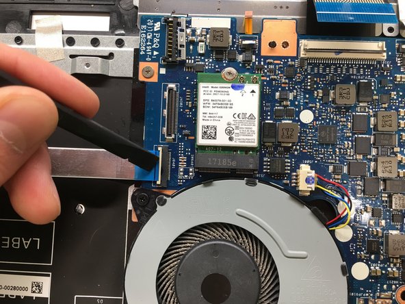

  16. Asus Q304UA Motherboard Replacement: crwdns2935265:016crwdnd2935265:01crwdnd2935265:03crwdne2935265:0 Asus Q304UA Motherboard Replacement: crwdns2935265:016crwdnd2935265:02crwdnd2935265:03crwdne2935265:0 Asus Q304UA Motherboard Replacement: crwdns2935265:016crwdnd2935265:03crwdnd2935265:03crwdne2935265:0
    • Use a spudger to flip up the retaining flap on the ribbon cable ZIP socket.
    • Use tweezers pull the ribbon cable out of the ZIF socket.

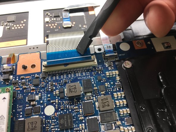

  17. Asus Q304UA Motherboard Replacement: crwdns2935265:017crwdnd2935265:01crwdnd2935265:03crwdne2935265:0 Asus Q304UA Motherboard Replacement: crwdns2935265:017crwdnd2935265:02crwdnd2935265:03crwdne2935265:0 Asus Q304UA Motherboard Replacement: crwdns2935265:017crwdnd2935265:03crwdnd2935265:03crwdne2935265:0
    • Use the tip of a spudger to flip up the retaining flap on the daughterboard ribbon cable ZIF socket on the motherboard.
    • Use tweezers to pull the ribbon cable away from the ZIF socket
