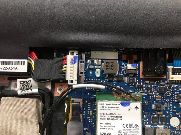

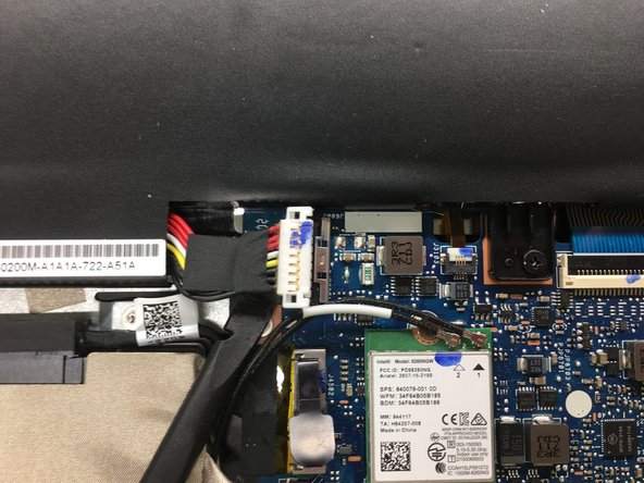

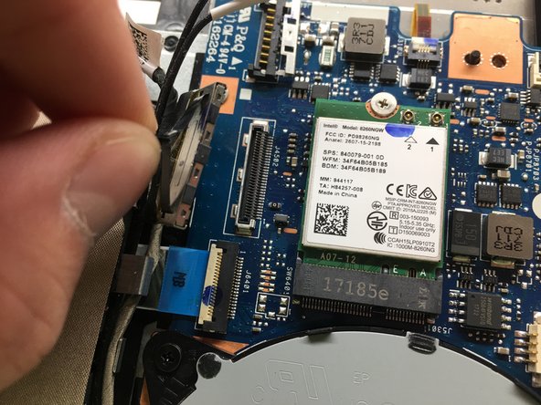

  3. Asus Q304UA Hard Drive Replacement, Disconnect the battery: crwdns2935265:03crwdnd2935265:01crwdnd2935265:03crwdne2935265:0 Asus Q304UA Hard Drive Replacement, Disconnect the battery: crwdns2935265:03crwdnd2935265:02crwdnd2935265:03crwdne2935265:0 Asus Q304UA Hard Drive Replacement, Disconnect the battery: crwdns2935265:03crwdnd2935265:03crwdnd2935265:03crwdne2935265:0
    • Push metal bracket away from battery connector.
    • Use a spudger to push the battery connection straight up.
    • If you pry too hard, or attempt to disconnect the battery with the metal bracket still in place, you risk pulling the connector off of the motherboard.
    • Make sure the computer is powered off before removing the battery.

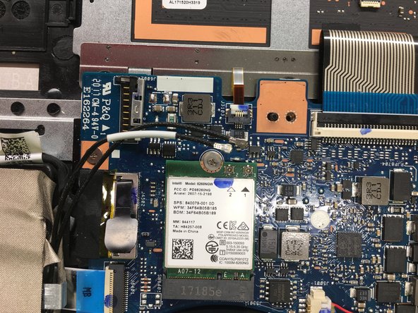

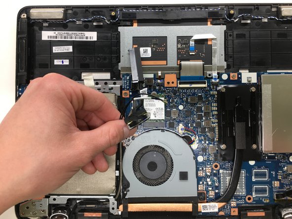

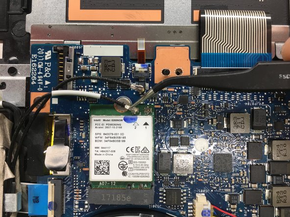

  4. Asus Q304UA Hard Drive Replacement, Disconnect RF Cables: crwdns2935265:04crwdnd2935265:01crwdnd2935265:03crwdne2935265:0 Asus Q304UA Hard Drive Replacement, Disconnect RF Cables: crwdns2935265:04crwdnd2935265:02crwdnd2935265:03crwdne2935265:0 Asus Q304UA Hard Drive Replacement, Disconnect RF Cables: crwdns2935265:04crwdnd2935265:03crwdnd2935265:03crwdne2935265:0
    • Disconnect the Wifi/Bluetooth RF cables from the wireless card.
    • Pull the RF cables by the metal connector, not by the rubber shielding. This avoids damaging the connector and the cable.

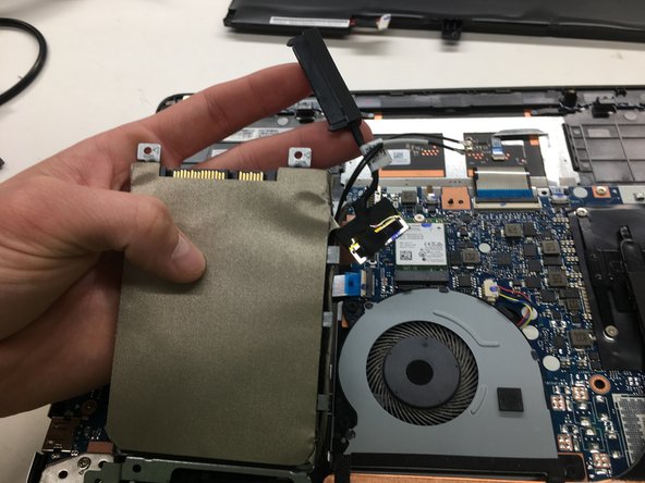

  7. Asus Q304UA Hard Drive Replacement: crwdns2935265:07crwdnd2935265:01crwdnd2935265:03crwdne2935265:0 Asus Q304UA Hard Drive Replacement: crwdns2935265:07crwdnd2935265:02crwdnd2935265:03crwdne2935265:0 Asus Q304UA Hard Drive Replacement: crwdns2935265:07crwdnd2935265:03crwdnd2935265:03crwdne2935265:0
    • Tilt the drive up slightly by the connector
    • Remove the SATA combo connector
  8. Asus Q304UA Hard Drive Replacement: crwdns2935265:08crwdnd2935265:01crwdnd2935265:02crwdne2935265:0 Asus Q304UA Hard Drive Replacement: crwdns2935265:08crwdnd2935265:02crwdnd2935265:02crwdne2935265:0
    • De-route the SATA and RF cables from the side of the drive bay.

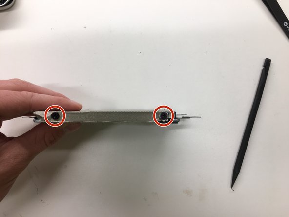

  10. Asus Q304UA Hard Drive Replacement, Hard Drive Bracket Assembly: crwdns2935265:010crwdnd2935265:01crwdnd2935265:02crwdne2935265:0 Asus Q304UA Hard Drive Replacement, Hard Drive Bracket Assembly: crwdns2935265:010crwdnd2935265:02crwdnd2935265:02crwdne2935265:0
    • Remove the four Phillips #0 screws that secure the hard drive to the hard drive bracket.
    • Four 3.7 mm screws

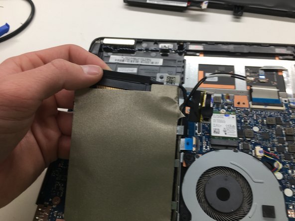

  11. Asus Q304UA Hard Drive Replacement: crwdns2935265:011crwdnd2935265:01crwdnd2935265:03crwdne2935265:0 Asus Q304UA Hard Drive Replacement: crwdns2935265:011crwdnd2935265:02crwdnd2935265:03crwdne2935265:0 Asus Q304UA Hard Drive Replacement: crwdns2935265:011crwdnd2935265:03crwdnd2935265:03crwdne2935265:0

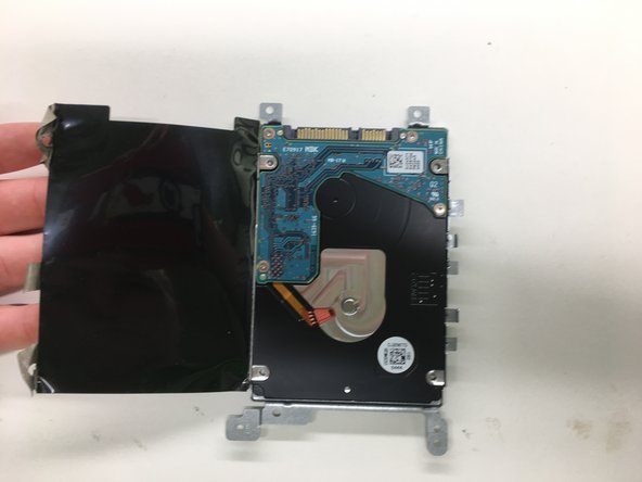

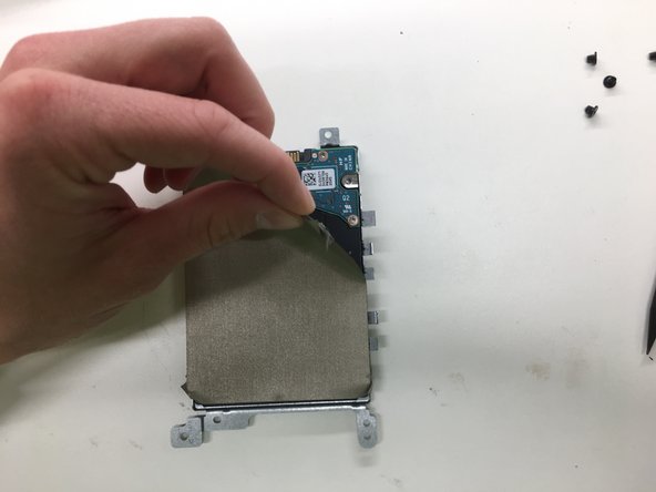

    • Peal back thermal cover.
    • Be careful not to tear the cover on the side of the drive as you peel it off.
  12. Asus Q304UA Hard Drive Replacement: crwdns2935265:012crwdnd2935265:01crwdnd2935265:01crwdne2935265:0
    • Remove drive from hard drive bracket.
