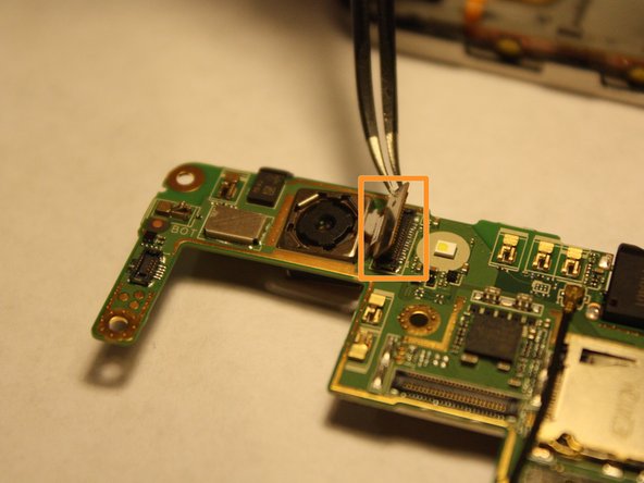

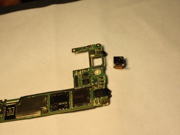

  3. Asus PadFone S Rear Facing Camera Replacement, Remove Back Camera: crwdns2935265:03crwdnd2935265:01crwdnd2935265:03crwdne2935265:0 Asus PadFone S Rear Facing Camera Replacement, Remove Back Camera: crwdns2935265:03crwdnd2935265:02crwdnd2935265:03crwdne2935265:0 Asus PadFone S Rear Facing Camera Replacement, Remove Back Camera: crwdns2935265:03crwdnd2935265:03crwdnd2935265:03crwdne2935265:0
    • The back camera is located at the top left on the logic board.
    • Use tweezers to lift back camera strip from logic board.
    • Lift back camera out of logic board.
    • It is not necessary to remove logic board for removal of the back camera.
