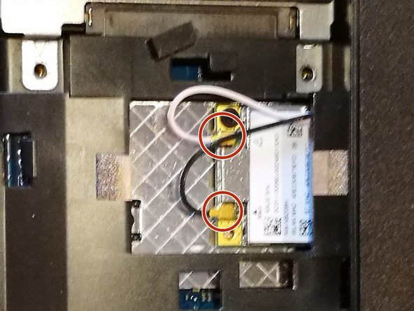

    8. Asus N551JQ thermal paste replacement: crwdns2935265:08crwdnd2935265:01crwdnd2935265:02crwdne2935265:0 Asus N551JQ thermal paste replacement: crwdns2935265:08crwdnd2935265:02crwdnd2935265:02crwdne2935265:0
      • Release the marked connector.
      • Release the Wi-Fi antennas.

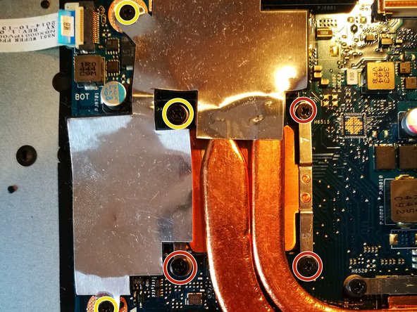

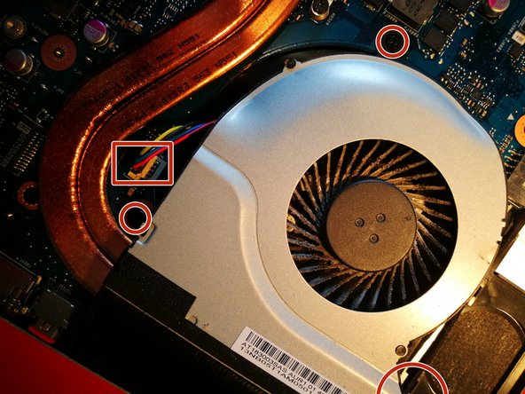

    16. Asus N551JQ thermal paste replacement, Remove the cooling unit: crwdns2935265:016crwdnd2935265:01crwdnd2935265:03crwdne2935265:0 Asus N551JQ thermal paste replacement, Remove the cooling unit: crwdns2935265:016crwdnd2935265:02crwdnd2935265:03crwdne2935265:0 Asus N551JQ thermal paste replacement, Remove the cooling unit: crwdns2935265:016crwdnd2935265:03crwdnd2935265:03crwdne2935265:0
      • Remove the red marked screws and the red marked connector.
      • Optionally remove the yellow marked screws.
    17. Asus N551JQ thermal paste replacement: crwdns2935265:017crwdnd2935265:01crwdnd2935265:02crwdne2935265:0 Asus N551JQ thermal paste replacement: crwdns2935265:017crwdnd2935265:02crwdnd2935265:02crwdne2935265:0

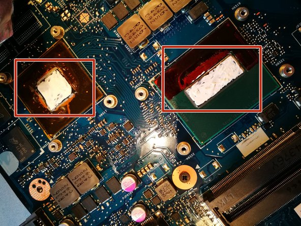

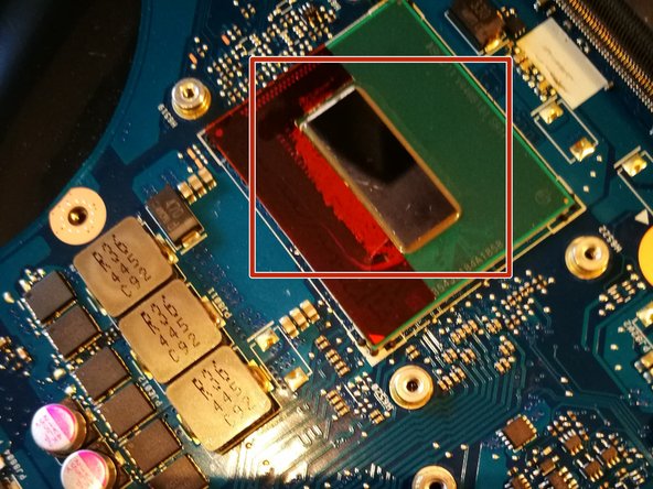

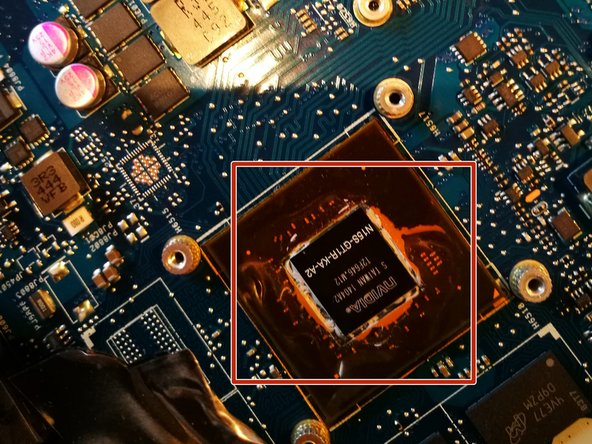

    18. Asus N551JQ thermal paste replacement, Cleaning chips: crwdns2935265:018crwdnd2935265:01crwdnd2935265:03crwdne2935265:0 Asus N551JQ thermal paste replacement, Cleaning chips: crwdns2935265:018crwdnd2935265:02crwdnd2935265:03crwdne2935265:0 Asus N551JQ thermal paste replacement, Cleaning chips: crwdns2935265:018crwdnd2935265:03crwdnd2935265:03crwdne2935265:0
      • Clean the processor and videocard chip, so the thermal paste will be removed.
      • If the paste is dried out, use some water or alcohol, not to much! Make sure to dry both.

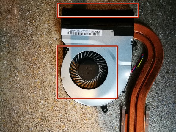

    19. Asus N551JQ thermal paste replacement, Cleaning cooling unit: crwdns2935265:019crwdnd2935265:01crwdnd2935265:02crwdne2935265:0 Asus N551JQ thermal paste replacement, Cleaning cooling unit: crwdns2935265:019crwdnd2935265:02crwdnd2935265:02crwdne2935265:0
      • Remove the (dried) thermal paste of the cooling unit.
      • Clean the dust, by using compressed air, or an paint brush.
      • When using an compressor/compressed air, block the fan, so it can not spin/rotate. Else it will damage!

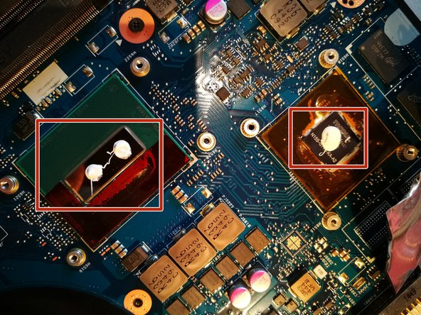

    20. Asus N551JQ thermal paste replacement, Apply new thermal paste: crwdns2935265:020crwdnd2935265:01crwdnd2935265:03crwdne2935265:0 Asus N551JQ thermal paste replacement, Apply new thermal paste: crwdns2935265:020crwdnd2935265:02crwdnd2935265:03crwdne2935265:0 Asus N551JQ thermal paste replacement, Apply new thermal paste: crwdns2935265:020crwdnd2935265:03crwdnd2935265:03crwdne2935265:0
      • Thermal paste is available in different versions.
      • Put one drop on the processor, two on the videocard. Use not to much (could counteract the cooling process).
      • Gently divide the thermal paste like on the picture, over the whole "metal" part of the chips.
