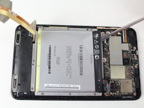

    • Make sure the device is turned off.
    • Carefully insert the opening tool on the edge of the phone.
    • Slowly lift up the panel from the device and repeat the process on the other side.
  2. Asus MeMO Pad 7 ME176C Speaker Replacement: crwdns2935265:02crwdnd2935265:01crwdnd2935265:03crwdne2935265:0 Asus MeMO Pad 7 ME176C Speaker Replacement: crwdns2935265:02crwdnd2935265:02crwdnd2935265:03crwdne2935265:0 Asus MeMO Pad 7 ME176C Speaker Replacement: crwdns2935265:02crwdnd2935265:03crwdnd2935265:03crwdne2935265:0
    • To disconnect the ZIF connectors. Place the metal spudger underneath the ZIF cable and gently pull it outward.
    • ZIF connectors are fragile, so work with caution.
  3. Asus MeMO Pad 7 ME176C Speaker Replacement: crwdns2935265:03crwdnd2935265:01crwdnd2935265:03crwdne2935265:0 Asus MeMO Pad 7 ME176C Speaker Replacement: crwdns2935265:03crwdnd2935265:02crwdnd2935265:03crwdne2935265:0 Asus MeMO Pad 7 ME176C Speaker Replacement: crwdns2935265:03crwdnd2935265:03crwdnd2935265:03crwdne2935265:0
    • The battery connector is located on the right-hand side of the device
    • To disconnect the battery connector. Use tweezers, and carefully lift up the wire.
    • Remove the battery.
  4. Asus MeMO Pad 7 ME176C Speaker Replacement: crwdns2935265:04crwdnd2935265:01crwdnd2935265:01crwdne2935265:0
    • Using a Philips Head Screwdriver PH000, locate the 2.6mm screws and gently unscrew them .
    • Place these screws somewhere you will remember.
    • Applying too much pressure onto the screen may cause it to break.
  5. Asus MeMO Pad 7 ME176C Speaker Replacement: crwdns2935265:05crwdnd2935265:01crwdnd2935265:03crwdne2935265:0 Asus MeMO Pad 7 ME176C Speaker Replacement: crwdns2935265:05crwdnd2935265:02crwdnd2935265:03crwdne2935265:0 Asus MeMO Pad 7 ME176C Speaker Replacement: crwdns2935265:05crwdnd2935265:03crwdnd2935265:03crwdne2935265:0
    • Using tweezers, disconnect the speaker cable connected to the motherboard.
    • Be sure not to damage other components on the motherboard.
    • After that remove the speaker system completely.
  6. Asus MeMO Pad 7 ME176C Speaker Replacement: crwdns2935265:06crwdnd2935265:01crwdnd2935265:01crwdne2935265:0
    • Now you can attach a new speaker!
