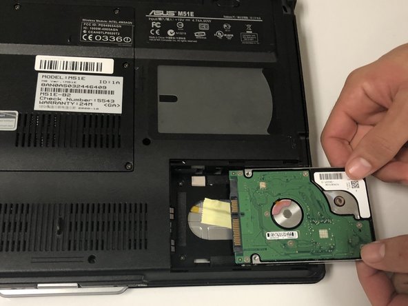

    • Before you proceed, make sure you have properly backed up or transferred the data from your old hard disk drive.
    • Use a Phillips #0 screwdriver to remove the two 2.5 millimeter screws holding the section of the case together.
    • Slide the case off of the hard drive section.
  2. Asus M51E-B2 Troubleshooting Hard Drive Replacement: crwdns2935265:02crwdnd2935265:01crwdnd2935265:02crwdne2935265:0 Asus M51E-B2 Troubleshooting Hard Drive Replacement: crwdns2935265:02crwdnd2935265:02crwdnd2935265:02crwdne2935265:0

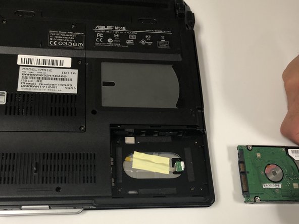

    • Once you have removed the section of the case covering the hard drive, you will see a metal cover over the hard drive.
    • Remove the four 2.5 millimeter screws on each cover of the hard drive cover. (Be sure to have a safe place to put them, as they are small and are easily lost.)
    • Once you have removed the screws holding the hard drive cover in place, pull on the plastic tab until the cover comes off. The cover is on tracks, so be sure to pull horizontally in order to avoid damaging your computer.
  3. Asus M51E-B2 Troubleshooting Hard Drive Replacement: crwdns2935265:03crwdnd2935265:01crwdnd2935265:03crwdne2935265:0 Asus M51E-B2 Troubleshooting Hard Drive Replacement: crwdns2935265:03crwdnd2935265:02crwdnd2935265:03crwdne2935265:0 Asus M51E-B2 Troubleshooting Hard Drive Replacement: crwdns2935265:03crwdnd2935265:03crwdnd2935265:03crwdne2935265:0
    • Now that you have removed the hard drive cover, you are able to remove the hard drive itself.
