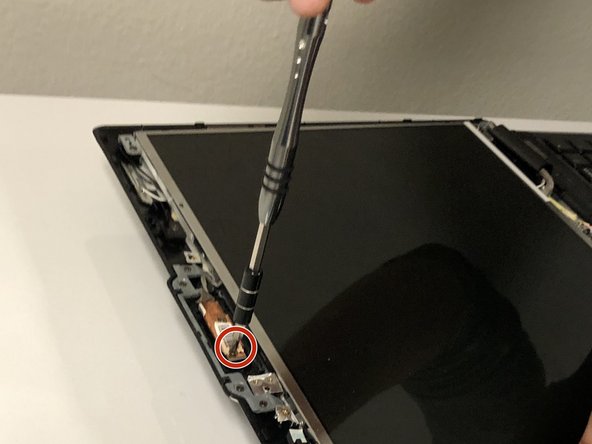

    • Use the Phillips PH0 head screwdriver to remove the two 2.5 mm screws located on the left side of the camera.
    • Use the Phillips PH0 head screwdriver to remove the one 2.5 millimeter screw that goes through the left side of the camera.
