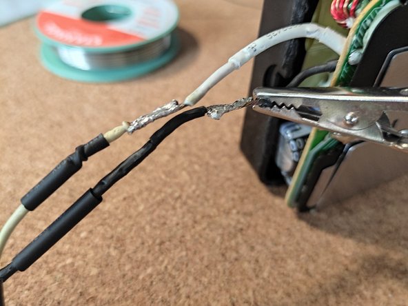

  3. Asus Laptop Charger Cable Repair, prepare the cables for soldering: crwdns2935265:03crwdnd2935265:01crwdnd2935265:01crwdne2935265:0
    • (3) use the wire cutters to peel the ends of the cables and leave around 1-2cm length of copper without cable tube.
    • you want to create an asymmetric shape so that there is no lump from stacking the cables when you solder them
    • you also need to cut and prepare the other end of the cable, the one with the connector. Do the opposite of what we did in the charger end, in the connector end, the black cable should be longer and the white cable shorter

  5. Asus Laptop Charger Cable Repair, tin the ends of the cable: crwdns2935265:05crwdnd2935265:01crwdnd2935265:02crwdne2935265:0 Asus Laptop Charger Cable Repair, tin the ends of the cable: crwdns2935265:05crwdnd2935265:02crwdnd2935265:02crwdne2935265:0
    • to leave an excellent solder, it's better if you solder the tips first.
    • clean the tip of the soldering iron
    • get the solder ready and test the tip of the soldering iron
    • heat the cable and slide the solder from the end of the cable to the tip
    • don't heat it too much or the heat shrink tubing will melt
  6. Asus Laptop Charger Cable Repair, join the cables: crwdns2935265:06crwdnd2935265:01crwdnd2935265:02crwdne2935265:0 Asus Laptop Charger Cable Repair, join the cables: crwdns2935265:06crwdnd2935265:02crwdnd2935265:02crwdne2935265:0
    • place one cable on top of the other, grip it with the helping hands, and put the soldering iron over it. Your already tined cable will fuse easily.
    • test each cable for continuity with the multimeter
    • one pin of the multimeter at the connector and one at the soldering joint of the cable at the motherboard
    • do this for each cable.

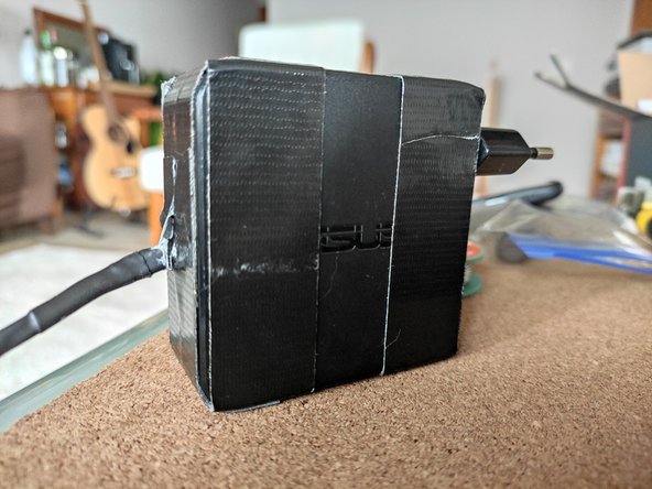

  8. Asus Laptop Charger Cable Repair, close the case and tape the perimeter: crwdns2935265:08crwdnd2935265:01crwdnd2935265:02crwdne2935265:0 Asus Laptop Charger Cable Repair, close the case and tape the perimeter: crwdns2935265:08crwdnd2935265:02crwdnd2935265:02crwdne2935265:0
    • put the case back together and grab the gorilla tape. Since this case is not meant to be repairable, you need gorilla tape to hold it in place.
    • i recommend doing it as shown in the graphic.
    • first wrap the perimeter closing the gap
    • next fix them together

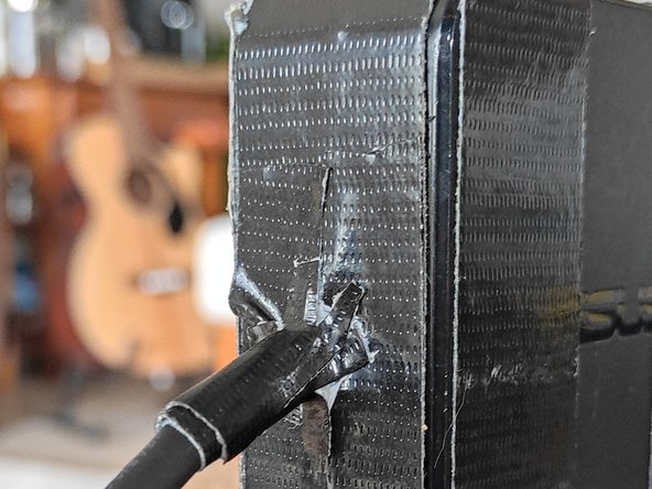

  9. Asus Laptop Charger Cable Repair, protect the cable area: crwdns2935265:09crwdnd2935265:01crwdnd2935265:03crwdne2935265:0 Asus Laptop Charger Cable Repair, protect the cable area: crwdns2935265:09crwdnd2935265:02crwdnd2935265:03crwdne2935265:0 Asus Laptop Charger Cable Repair, protect the cable area: crwdns2935265:09crwdnd2935265:03crwdnd2935265:03crwdne2935265:0
    • use gorilla tape again to tape the cable to the case as shown in the figure
    • cut a piece of gorilla tape with a length similar to the perimeter of the cable
    • trim the edges so that you can tape it to the flat surface of the charger
    • you are done! great job!
