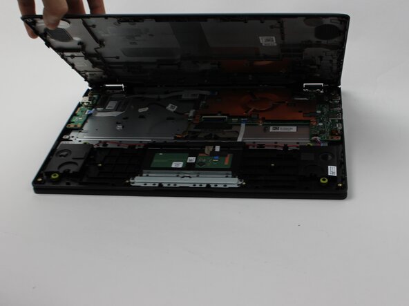

    • Remove ten 6 mm screws that secure the lower case using a Phillips #1 screwdriver.
    • Carefully remove the lower case.
