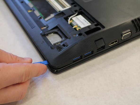

  6. Asus K55a-si50301p USB 3.0 Replacement: crwdns2935265:06crwdnd2935265:01crwdnd2935265:02crwdne2935265:0 Asus K55a-si50301p USB 3.0 Replacement: crwdns2935265:06crwdnd2935265:02crwdnd2935265:02crwdne2935265:0
    • Use the iFixit opening tool around the outside line where the top of the laptop meets the bottom to separate components.
