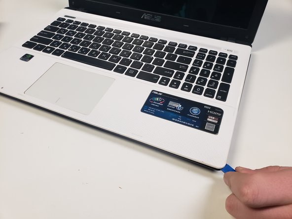

    • After the screws are removed, Orientate the device so that the keyboard is shown.
    • Using the Plastic Pry tool separate the keyboard panel from the rest of the laptop.

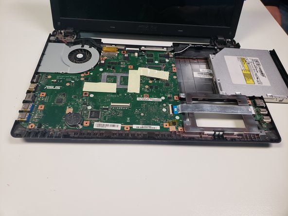

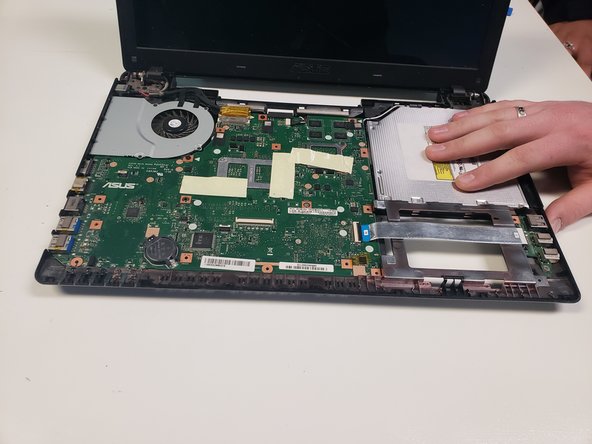

    • Remove the optical dive by sliding it outward.
  8. Asus K55VD Fan Replacement: crwdns2935265:09crwdnd2935265:01crwdnd2935265:03crwdne2935265:0 Asus K55VD Fan Replacement: crwdns2935265:09crwdnd2935265:02crwdnd2935265:03crwdne2935265:0 Asus K55VD Fan Replacement: crwdns2935265:09crwdnd2935265:03crwdnd2935265:03crwdne2935265:0

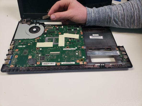

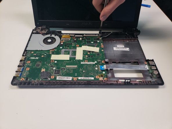

    • Now remove the two wires shown by pulling away from the motherboard.
  9. Asus K55VD Fan Replacement: crwdns2935265:010crwdnd2935265:01crwdnd2935265:03crwdne2935265:0 Asus K55VD Fan Replacement: crwdns2935265:010crwdnd2935265:02crwdnd2935265:03crwdne2935265:0 Asus K55VD Fan Replacement: crwdns2935265:010crwdnd2935265:03crwdnd2935265:03crwdne2935265:0

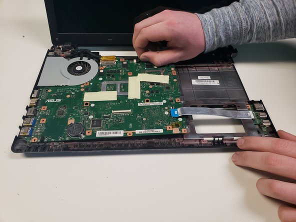

    • Remove the three screws holding the motherboard and fan in place using the Phillips #0 bit.
    • The top left screw shown in the first picture is easily broken
  10. Asus K55VD Fan Replacement: crwdns2935265:011crwdnd2935265:01crwdnd2935265:03crwdne2935265:0 Asus K55VD Fan Replacement: crwdns2935265:011crwdnd2935265:02crwdnd2935265:03crwdne2935265:0 Asus K55VD Fan Replacement: crwdns2935265:011crwdnd2935265:03crwdnd2935265:03crwdne2935265:0

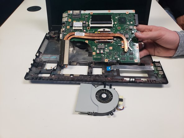

    • lift up on the entire motherboard and unplug the bottom wires connected to the fan.
  11. Asus K55VD Fan Replacement: crwdns2935265:012crwdnd2935265:01crwdnd2935265:02crwdne2935265:0 Asus K55VD Fan Replacement: crwdns2935265:012crwdnd2935265:02crwdnd2935265:02crwdne2935265:0
    • After all cords have been removed, the fan can be removed as well.

At step 5, you should also unscrew the bottom silver screw and unplug the wifi antennas.
https://i.imgur.com/vRrlRkv.png
Daniel - crwdns2934203:0crwdne2934203:0
At step 3, the bottom left screw does not hold down the drive bay. Unsrew that screw in step 5.
