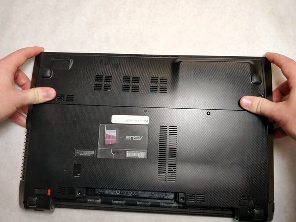

    • Flip the laptop over, such that the bottom of the laptop is facing upwards.
    • Ensure that the laptop is powered off prior to following this guide.
  2. Asus K55N-DS81 RAM Replacement: crwdns2935265:02crwdnd2935265:01crwdnd2935265:02crwdne2935265:0 Asus K55N-DS81 RAM Replacement: crwdns2935265:02crwdnd2935265:02crwdnd2935265:02crwdne2935265:0
    • Pull the latch to the right of the battery to the right.
  3. Asus K55N-DS81 RAM Replacement: crwdns2935265:03crwdnd2935265:01crwdnd2935265:02crwdne2935265:0 Asus K55N-DS81 RAM Replacement: crwdns2935265:03crwdnd2935265:02crwdnd2935265:02crwdne2935265:0
    • Pull the latch to the left of the battery to the left. Hold the latch open with a finger to prevent it from closing.
  4. Asus K55N-DS81 RAM Replacement: crwdns2935265:04crwdnd2935265:01crwdnd2935265:02crwdne2935265:0 Asus K55N-DS81 RAM Replacement: crwdns2935265:04crwdnd2935265:02crwdnd2935265:02crwdne2935265:0
    • While holding the second latch from the previous step, use another hand to reach underneath the battery.
    • Pull the battery upwards and away from the laptop to remove it.
  5. Asus K55N-DS81 RAM Replacement, Rear Panel: crwdns2935265:05crwdnd2935265:01crwdnd2935265:02crwdne2935265:0 Asus K55N-DS81 RAM Replacement, Rear Panel: crwdns2935265:05crwdnd2935265:02crwdnd2935265:02crwdne2935265:0
    • Using a JIS #00 screwdriver, unscrew the two 5 mm screws on either side of the laptop panel.
  6. Asus K55N-DS81 RAM Replacement: crwdns2935265:06crwdnd2935265:01crwdnd2935265:03crwdne2935265:0 Asus K55N-DS81 RAM Replacement: crwdns2935265:06crwdnd2935265:02crwdnd2935265:03crwdne2935265:0 Asus K55N-DS81 RAM Replacement: crwdns2935265:06crwdnd2935265:03crwdnd2935265:03crwdne2935265:0
    • Remove the panel by pushing away from the laptop until the panel is free of the laptop.
    • Lift to remove the panel.

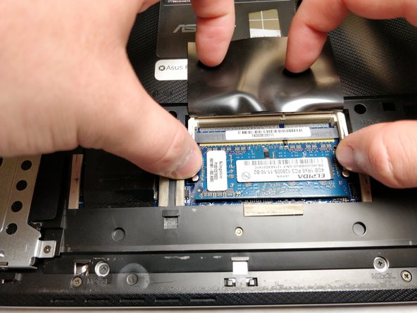

  7. Asus K55N-DS81 RAM Replacement, RAM: crwdns2935265:07crwdnd2935265:01crwdnd2935265:02crwdne2935265:0 Asus K55N-DS81 RAM Replacement, RAM: crwdns2935265:07crwdnd2935265:02crwdnd2935265:02crwdne2935265:0
    • Lift up the plastic static shield atop the RAM slots.
  8. Asus K55N-DS81 RAM Replacement: crwdns2935265:08crwdnd2935265:01crwdnd2935265:02crwdne2935265:0 Asus K55N-DS81 RAM Replacement: crwdns2935265:08crwdnd2935265:02crwdnd2935265:02crwdne2935265:0
    • Depress the tongs on either side of the RAM stick to loosen the RAM from the slot.
  9. Asus K55N-DS81 RAM Replacement: crwdns2935265:09crwdnd2935265:01crwdnd2935265:02crwdne2935265:0 Asus K55N-DS81 RAM Replacement: crwdns2935265:09crwdnd2935265:02crwdnd2935265:02crwdne2935265:0
    • Grab the RAM and pull away from the slot to release it.
