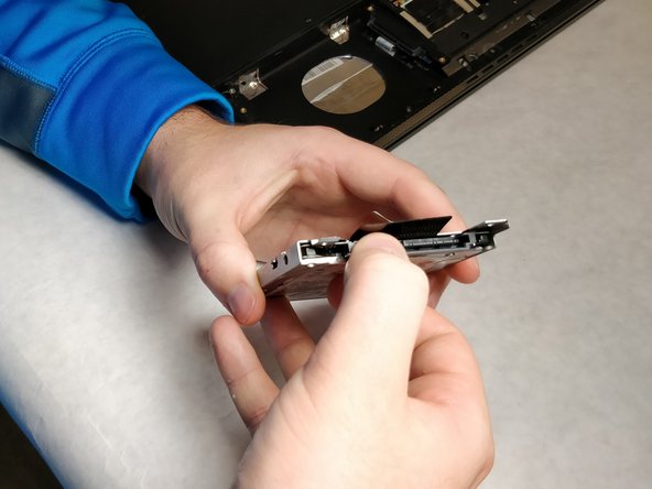

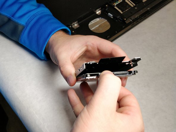

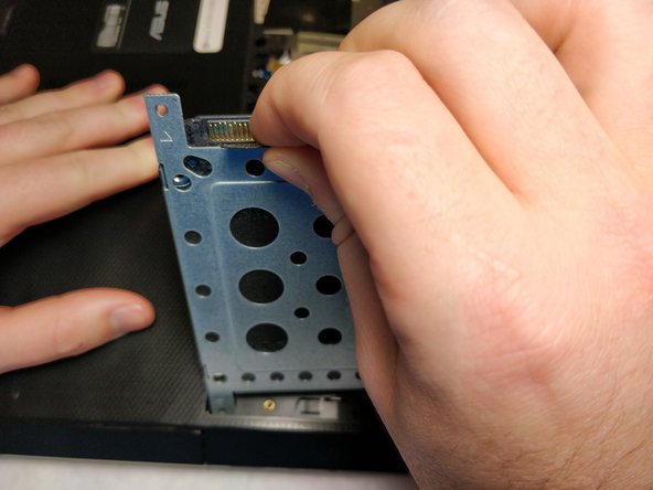

  8. Asus K55N-DS81 Hard Drive Replacement: crwdns2935265:08crwdnd2935265:01crwdnd2935265:03crwdne2935265:0 Asus K55N-DS81 Hard Drive Replacement: crwdns2935265:08crwdnd2935265:02crwdnd2935265:03crwdne2935265:0 Asus K55N-DS81 Hard Drive Replacement: crwdns2935265:08crwdnd2935265:03crwdnd2935265:03crwdne2935265:0
    • Grab the plastic tab located on the hard drive enclosure.
    • Pull the tab towards yourself, the hard drive will slide towards you as it disconnects from the motherboard.
    • Lift the enclosure by the tab to remove the enclosure from the laptop.

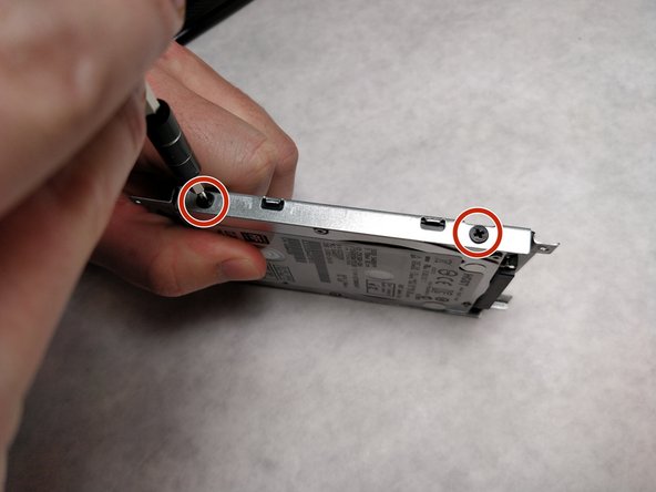

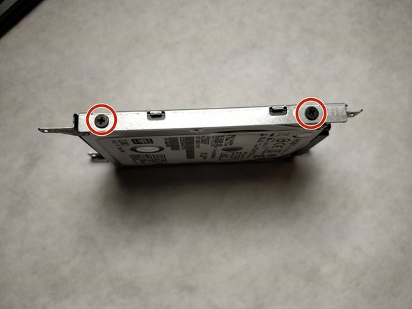

  9. Asus K55N-DS81 Hard Drive Replacement: crwdns2935265:09crwdnd2935265:01crwdnd2935265:02crwdne2935265:0 Asus K55N-DS81 Hard Drive Replacement: crwdns2935265:09crwdnd2935265:02crwdnd2935265:02crwdne2935265:0
    • Using a JIS #00 screwdriver, unscrew the four 3 mm screws securing the hard drive to the enclosure.
    • Do not forget to flip the enclosure over and unscrew the screws on the other side.
  10. Asus K55N-DS81 Hard Drive Replacement: crwdns2935265:010crwdnd2935265:01crwdnd2935265:02crwdne2935265:0 Asus K55N-DS81 Hard Drive Replacement: crwdns2935265:010crwdnd2935265:02crwdnd2935265:02crwdne2935265:0
    • Grab the hard drive and pull it away from the enclosure to remove it.
