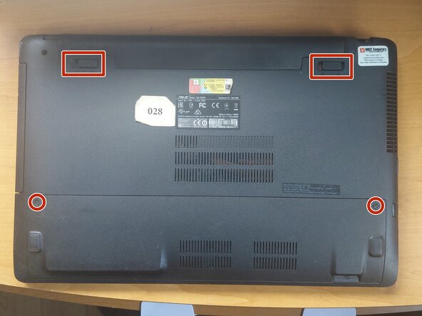

    • Remove the battery and unscrew the 2 screws that hold the back panel in place.
    • Remove the SSD and the rest of the screws that hold the palmrest.
    • Here you can upgrade the SSD and RAM before finishing the reassembly.

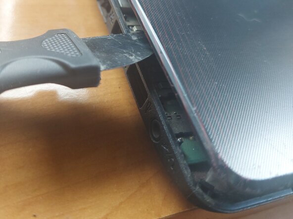

    • Use a prying tool to release all the clips of the palmrest.
    • Carefully disconnect the keyboard, touchpad and power button connectors.
    • Remove the palmrest to reveal the motherboard.
