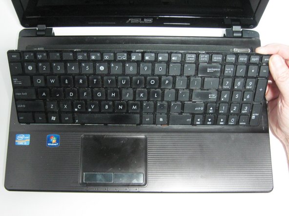

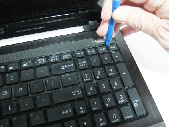

      • Flip the laptop over and open the lid to reveal the keyboard.
      • Insert the blue prying tool into each of the five tabs located at the top of the keyboard, pulling upwards on the keyboard to separate it from the palm rest.
      • Once the top of the keyboard has been separated from the device, slowly begin pulling the keyboard away from the laptop using your hands.
      • A silver ribbon cable is connected to the keyboard and the palm rest of the laptop. Removing the keyboard quickly may tear the silver ribbon cable, causing harm to your device.

Most of these steps are unnecessary to get to the dvd-drive. The keyboard clicks loose without removing these screws too, so only steps 7, 8 and 9 are needed.
