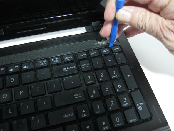

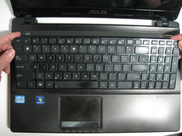

    • Using the blue prying tool, separate the keyboard from the palm rest by inserting the prying tool into each of the five tabs at the top of the keyboard.
    • Slowly remove the keyboard by gently pulling the keyboard away from the palm rest.
    • A silver ribbon cable is connected to the keyboard and the palm rest of the laptop. Removing the keyboard quickly may tear the silver ribbon cable, causing harm to your device.
  6. Asus K53E-BBR7 Fan Replacement: crwdns2935265:06crwdnd2935265:01crwdnd2935265:01crwdne2935265:0

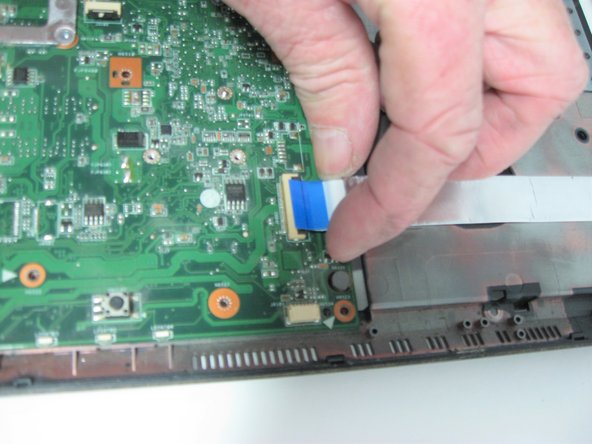

    • Using your fingers, slowly remove the silver ribbon cable from the laptop by disconnecting it from its connector.
    • Be careful when removing the ribbon. Pulling carelessly can cause damage to both the ribbon and the laptop.

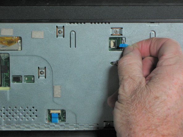

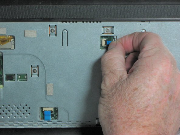

    • Use your fingers to gently disconnect the following cables from your laptop:
    • Power button cable.
    • Touchpad cable.
  9. Asus K53E-BBR7 Fan Replacement: crwdns2935265:09crwdnd2935265:01crwdnd2935265:01crwdne2935265:0

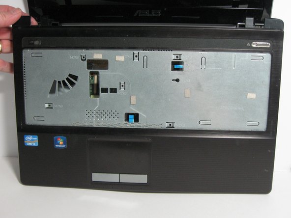

    • Slide the blue prying tool between the palm rest and the base of the laptop to separate them.
    • Carefully remove the palm rest from your device using your hands.

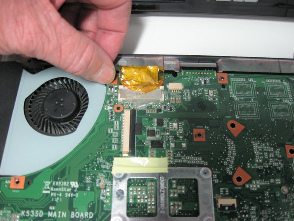

    • Detach the gold video cable from the motherboard using your fingers.
    • Using your fingers, detach the speaker cable from the motherboard.
    • Slowly lift the blue tape from the motherboard and remove the i/o board cable.

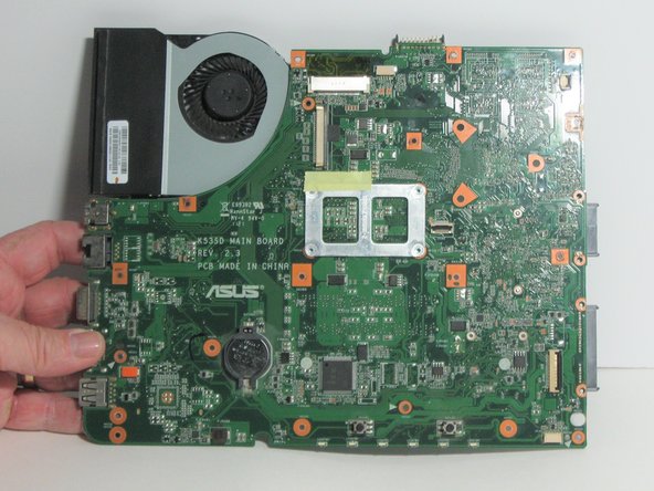

  13. Asus K53E-BBR7 Fan Replacement: crwdns2935265:013crwdnd2935265:01crwdnd2935265:02crwdne2935265:0 Asus K53E-BBR7 Fan Replacement: crwdns2935265:013crwdnd2935265:02crwdnd2935265:02crwdne2935265:0

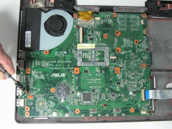

    • Remove nine 7.0 mm Phillips #0 screws from the motherboard using your Phillips #0 screwdriver.
  14. Asus K53E-BBR7 Fan Replacement: crwdns2935265:014crwdnd2935265:01crwdnd2935265:03crwdne2935265:0 Asus K53E-BBR7 Fan Replacement: crwdns2935265:014crwdnd2935265:02crwdnd2935265:03crwdne2935265:0 Asus K53E-BBR7 Fan Replacement: crwdns2935265:014crwdnd2935265:03crwdnd2935265:03crwdne2935265:0
    • Use your hands to lift the motherboard from the laptop.
    • The fan and several ports will be attached to the motherboard when it has been detached from the laptop.

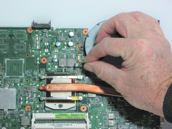

  15. Asus K53E-BBR7 Fan Replacement, Fan: crwdns2935265:015crwdnd2935265:01crwdnd2935265:02crwdne2935265:0 Asus K53E-BBR7 Fan Replacement, Fan: crwdns2935265:015crwdnd2935265:02crwdnd2935265:02crwdne2935265:0
    • Turn the motherboard over to access the fan and the heat sink.
  16. Asus K53E-BBR7 Fan Replacement: crwdns2935265:016crwdnd2935265:01crwdnd2935265:02crwdne2935265:0 Asus K53E-BBR7 Fan Replacement: crwdns2935265:016crwdnd2935265:02crwdnd2935265:02crwdne2935265:0

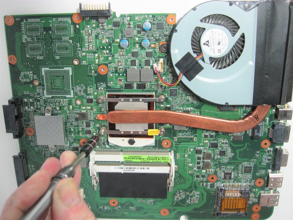

    • Disconnect the black, red, yellow, and blue set of wires from the motherboard using your fingers.
  17. Asus K53E-BBR7 Fan Replacement: crwdns2935265:017crwdnd2935265:01crwdnd2935265:02crwdne2935265:0 Asus K53E-BBR7 Fan Replacement: crwdns2935265:017crwdnd2935265:02crwdnd2935265:02crwdne2935265:0
    • Remove the four 6.0 mm Phillips #0 screws from the heat sink using your Phillips #0 screwdriver.
  18. Asus K53E-BBR7 Fan Replacement: crwdns2935265:018crwdnd2935265:01crwdnd2935265:03crwdne2935265:0 Asus K53E-BBR7 Fan Replacement: crwdns2935265:018crwdnd2935265:02crwdnd2935265:03crwdne2935265:0 Asus K53E-BBR7 Fan Replacement: crwdns2935265:018crwdnd2935265:03crwdnd2935265:03crwdne2935265:0
    • Detach the fan from the motherboard. The fan is attached to the motherboard with a light layer of thermal paste, requiring a prying tool to loosen the adhesive.
    • When replacing your fan, apply a small layer of thermal paste to the CPU before reattaching the heat sink.
