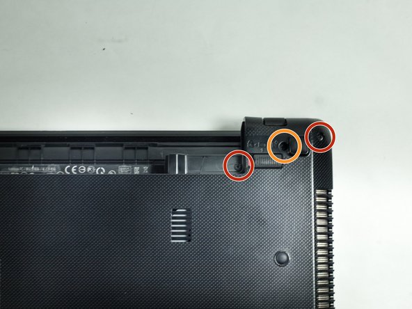

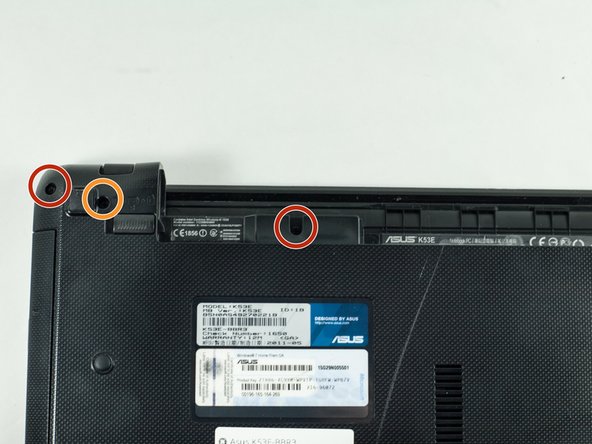

    • On the back of the laptop unscrew the eighteen 5mm Phillips #1 screws.
    • Unscrew the two 5mm Phillips #1 screws.
    • The screws highlighted in orange are slightly thicker than those in red, however they are the same length and head type.

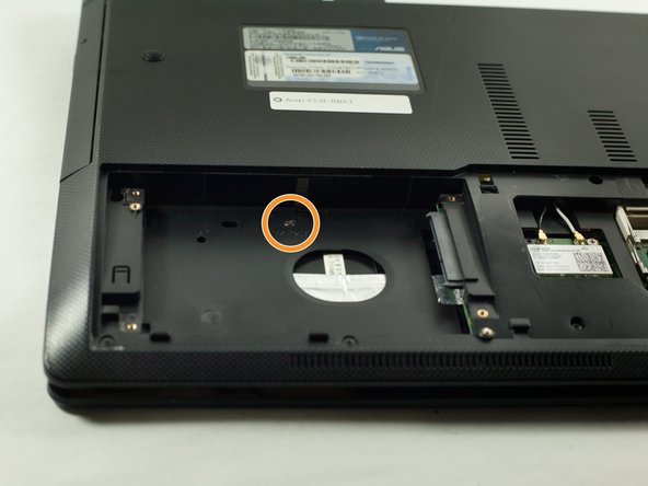

    • Unscrew the four highlighted 5mm Phillips #1 screws, and remove the hard drive.
    • Unscrew the 3mm Phillips #1 screw.

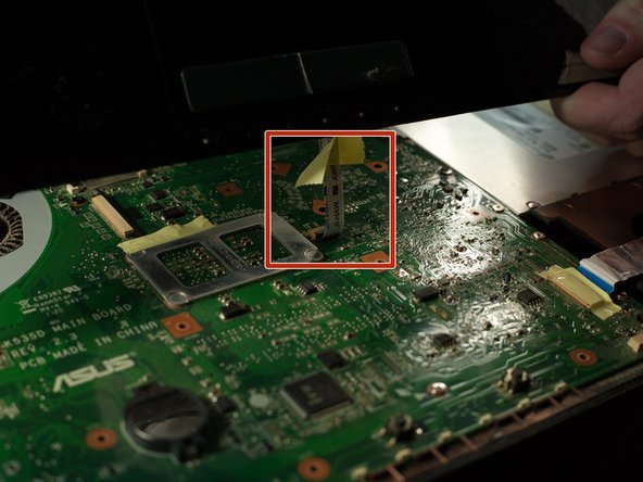

    • There is a ribbon connector that is connecting the two halves of the laptop. So when opening the two plastic pieces be careful not to damage the cable.
    • Using the plastic opening tool, firmly pry apart the two sections of plastic.
    • Firmly shimmy the opening tool around the laptop prying the two sections of plastic apart.
    • Disconnect the highlighted ribbon cable, by pulling up on the black tab and gently pulling the cable out of its port.

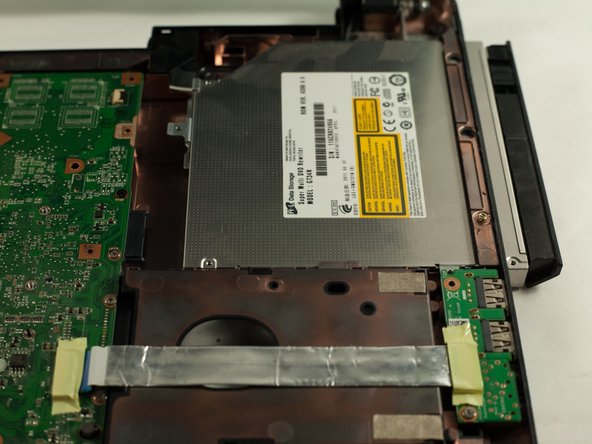

    • Unscrew the three 3mm Phillips #0 screws.
    • Slide the optical drive to the right.
    • Remove the optical drive.
