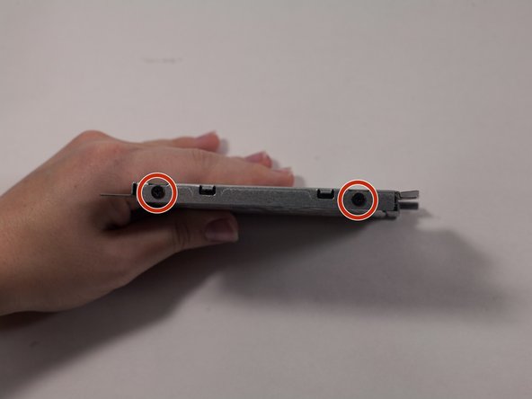

  5. Asus K53E-BBR3 Hard Drive Replacement: crwdns2935265:05crwdnd2935265:01crwdnd2935265:02crwdne2935265:0 Asus K53E-BBR3 Hard Drive Replacement: crwdns2935265:05crwdnd2935265:02crwdnd2935265:02crwdne2935265:0
    • Unscrew the screws on the hard drive case.
    • Two 3mm Phillips #1 screws are located on one edge of the case.
    • The last two 3mm #1 Phillips screws are located on the opposite side of the case.
    • After you unscrew all four screws, the metal cage will fall off, leaving you with the hard drive.
