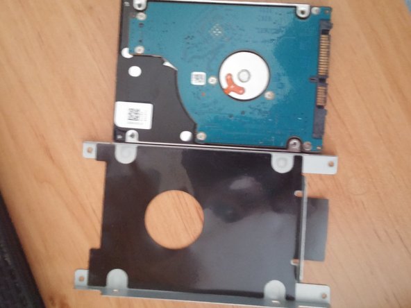

  4. Asus K52JC Laptop Hard Drive Replacement, Remove the hard drive from its metal support bracket: crwdns2935265:04crwdnd2935265:01crwdnd2935265:03crwdne2935265:0 Asus K52JC Laptop Hard Drive Replacement, Remove the hard drive from its metal support bracket: crwdns2935265:04crwdnd2935265:02crwdnd2935265:03crwdne2935265:0 Asus K52JC Laptop Hard Drive Replacement, Remove the hard drive from its metal support bracket: crwdns2935265:04crwdnd2935265:03crwdnd2935265:03crwdne2935265:0
    • Remove the 4 screws located on the side of the support.
    • Then, remove the hard drive form its metallic support.
    • Finally, replace de hard drive with a new one or an SSD.
To reassemble your device, follow these steps in reverse order.

You can do this to replace a faulty hard-drive or replace it by a SSD to get better performance. So I did this to replace mine by a new one and I wrote this guide for other people who search how to do it. As you can see, very easy to do.
