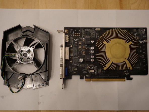

    • Finally, with the GPU unit exposed, disconnect the 4-pin fan power and speed control cable from the circuit board.
    • Refer to the photographs on the left if needed.

    • Remove the four smallest screws that are holding the fan shroud in place.
    • Do so by using a (Phillips #00) screwdriver between the fan blades and corresponding supporting bracket.
  5. Asus GTX 750 GPU Fan Replacement: crwdns2935265:05crwdnd2935265:01crwdnd2935265:02crwdne2935265:0 Asus GTX 750 GPU Fan Replacement: crwdns2935265:05crwdnd2935265:02crwdnd2935265:02crwdne2935265:0
    • Locate the two clips on either side of the fan shroud.
    • Then, pull the clips slightly to the side and release the fan shroud from the heatsink.
    • Finally, pull the fan shroud vertically to remove from the device and allow for an unobstructed review and repair.
  6. Asus GTX 750 GPU Fan Replacement: crwdns2935265:06crwdnd2935265:01crwdnd2935265:01crwdne2935265:0
    • At this stage, you may reverse the disassembly process to reassemble the fan shroud and place it within the unit.
In order to reassemble this device, follow the provided instructions in the reverse order.
