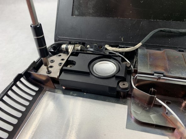

  13. Asus GL551JW-AH71 Display Assembly Replacement, Display Assembly: crwdns2935265:013crwdnd2935265:01crwdnd2935265:02crwdne2935265:0 Asus GL551JW-AH71 Display Assembly Replacement, Display Assembly: crwdns2935265:013crwdnd2935265:02crwdnd2935265:02crwdne2935265:0
    • Remove the three 5mm screws located in each circle with a Phillips #000 screwdriver.
    • A total of twelve 5mm screw should be removed in order to free the display assembly from the base.
  14. Asus GL551JW-AH71 Display Assembly Replacement: crwdns2935265:014crwdnd2935265:01crwdnd2935265:02crwdne2935265:0 Asus GL551JW-AH71 Display Assembly Replacement: crwdns2935265:014crwdnd2935265:02crwdnd2935265:02crwdne2935265:0
    • Lift the display assembly up, separating it from the base of the device.

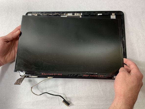

  15. Asus GL551JW-AH71 Display Assembly Replacement: crwdns2935265:015crwdnd2935265:01crwdnd2935265:03crwdne2935265:0 Asus GL551JW-AH71 Display Assembly Replacement: crwdns2935265:015crwdnd2935265:02crwdnd2935265:03crwdne2935265:0 Asus GL551JW-AH71 Display Assembly Replacement: crwdns2935265:015crwdnd2935265:03crwdnd2935265:03crwdne2935265:0
    • Using a plastic opening tool, separate the bezel from the screen.
    • Insert the tool and slide it right to left to release the bezel from the screen.
  16. Asus GL551JW-AH71 Display Assembly Replacement: crwdns2935265:016crwdnd2935265:01crwdnd2935265:02crwdne2935265:0 Asus GL551JW-AH71 Display Assembly Replacement: crwdns2935265:016crwdnd2935265:02crwdnd2935265:02crwdne2935265:0
    • Remove the four screws using a Phillips #0 screwdriver.
  17. Asus GL551JW-AH71 Display Assembly Replacement: crwdns2935265:017crwdnd2935265:01crwdnd2935265:02crwdne2935265:0 Asus GL551JW-AH71 Display Assembly Replacement: crwdns2935265:017crwdnd2935265:02crwdnd2935265:02crwdne2935265:0
    • Grab the screen in the corners and lift up to remove it.
