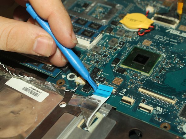

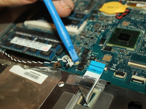

  5. Asus G75VW-BHI7N07 USB Port Replacement: crwdns2935265:05crwdnd2935265:01crwdnd2935265:03crwdne2935265:0 Asus G75VW-BHI7N07 USB Port Replacement: crwdns2935265:05crwdnd2935265:02crwdnd2935265:03crwdne2935265:0 Asus G75VW-BHI7N07 USB Port Replacement: crwdns2935265:05crwdnd2935265:03crwdnd2935265:03crwdne2935265:0
    • Now that the fans are exposed, use the opening tool to unhook them at the 4 connecting points.
    • Detach the blue-colored electrical component using the opening tool.
    • Detach the white and black colored electrical component using the opening tool.
