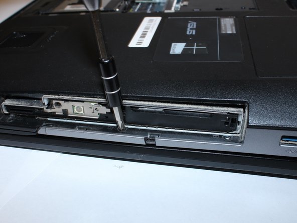

    • Remove the cover for the disc drive with the opening tool.
    • Remove the 6 (4 mm) 'B' marked screws with the PH1 Phillips-head screwdriver. (3 screws are in the battery compartment and 3 are under the disc drive cover)

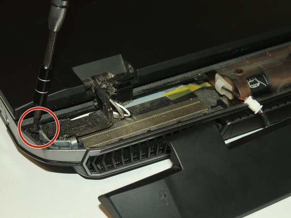

    • Take off the henge cover using the opening tool.
    • Remove the 2 black outside edge (9 mm) screws with the J0 Phillips screwdriver.

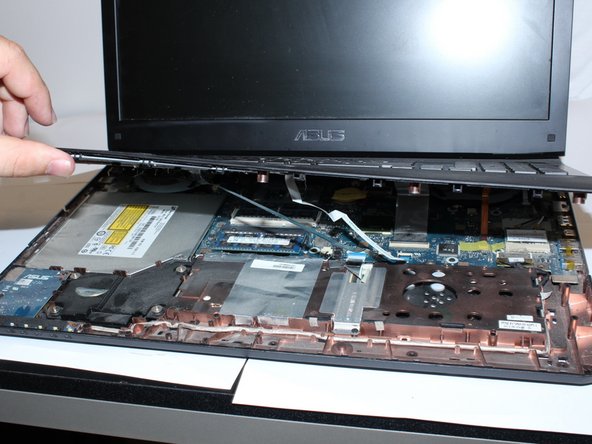

    • Pry open the keypad platform with the opening tool.
    • You will need to lift the keypad platform with your hands.
    • Remove all electrical connections using your hands.

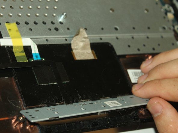

    • Take the 2 (3 mm) screws out of the trackpad using the PH1 Phillips screwdriver.
    • Remove the trackpad buttons using your hands.
