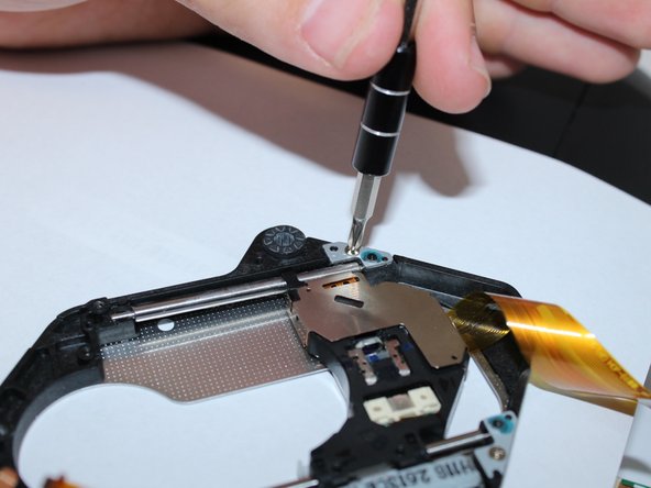

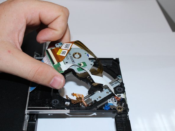

    • Remove optical assembly by hand.
    • Remove disc reader by removing 2 bolts from the top using the J0 Phillips-head screwdriver.
    • Lift the metal piece out.
    • Make sure no edges are sticking out when putting the metal plate back in place.
