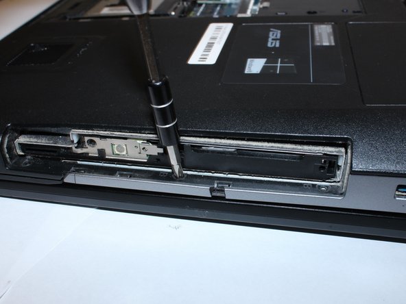

  3. Asus G75VW-BHI7N07 Audio Jack  Replacement: crwdns2935265:03crwdnd2935265:01crwdnd2935265:02crwdne2935265:0 Asus G75VW-BHI7N07 Audio Jack  Replacement: crwdns2935265:03crwdnd2935265:02crwdnd2935265:02crwdne2935265:0
    • Remove the cover for the disc drive with the opening tool.
    • Remove the 6 (4 mm) 'B' marked screws with the PH1 Phillips-head screwdriver. (3 screws are in the battery compartment and 3 are under the disc drive cover)

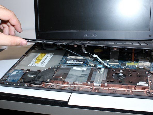

  4. Asus G75VW-BHI7N07 Audio Jack  Replacement: crwdns2935265:04crwdnd2935265:01crwdnd2935265:02crwdne2935265:0 Asus G75VW-BHI7N07 Audio Jack  Replacement: crwdns2935265:04crwdnd2935265:02crwdnd2935265:02crwdne2935265:0
    • Pry open the keypad platform with the opening tool.
    • You will need to lift the keypad platform with your hands to get to the laptop's internal systems.

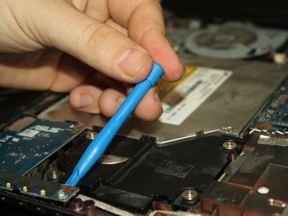

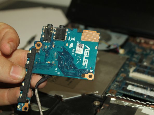

  5. Asus G75VW-BHI7N07 Audio Jack  Replacement: crwdns2935265:05crwdnd2935265:01crwdnd2935265:03crwdne2935265:0 Asus G75VW-BHI7N07 Audio Jack  Replacement: crwdns2935265:05crwdnd2935265:02crwdnd2935265:03crwdne2935265:0 Asus G75VW-BHI7N07 Audio Jack  Replacement: crwdns2935265:05crwdnd2935265:03crwdnd2935265:03crwdne2935265:0
    • Take out 1 (5mm) screw, using the J0 Phillips head screwdriver.
    • Use the opening tool to remove the audio-electrical board.
    • Lift out with your hands.
