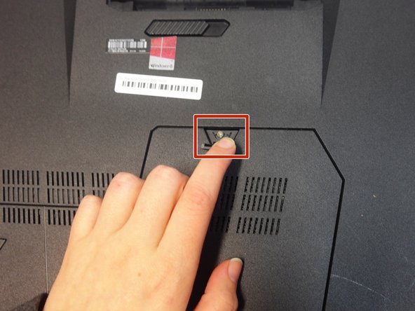

    • Power off and unplug your laptop, then turn it over.
  2. Asus G750JW-BBI7N05 RAM Replacement: crwdns2935265:02crwdnd2935265:01crwdnd2935265:01crwdne2935265:0
    • Slide the battery release latch all the way to the right. This will cause the battery to "pop" out slightly.
  3. Asus G750JW-BBI7N05 RAM Replacement: crwdns2935265:03crwdnd2935265:01crwdnd2935265:01crwdne2935265:0
    • Remove the battery from its compartment.
  4. Asus G750JW-BBI7N05 RAM Replacement, RAM: crwdns2935265:04crwdnd2935265:01crwdnd2935265:02crwdne2935265:0 Asus G750JW-BBI7N05 RAM Replacement, RAM: crwdns2935265:04crwdnd2935265:02crwdnd2935265:02crwdne2935265:0
    • Lift up the rubber stopper on the backplate to expose one Phillips screw. Unscrew it until it becomes loose.
    • This screw is permanently connected to the backplate and cannot be removed. Unscrewing it only allows you to remove the backplate from the laptop.
    • The backpate is the plastic plate on the underside of the laptop that covers some of its easily accessible internal components.
  5. Asus G750JW-BBI7N05 RAM Replacement: crwdns2935265:05crwdnd2935265:01crwdnd2935265:01crwdne2935265:0
    • Use an opening tool to pry up the backplate along its edges, then remove it.
    • You may need to apply some force when prying up the backplate.
    • Keep in mind: During reassembly, replace the backplate starting from the bottom.
  6. Asus G750JW-BBI7N05 RAM Replacement: crwdns2935265:06crwdnd2935265:01crwdnd2935265:02crwdne2935265:0 Asus G750JW-BBI7N05 RAM Replacement: crwdns2935265:06crwdnd2935265:02crwdnd2935265:02crwdne2935265:0
    • During the recycling process, this laptop lost some of its parts. In this step, its top two RAM modules are missing.
    • Remove each RAM module one at a time by sliding them downward out of their slots.
