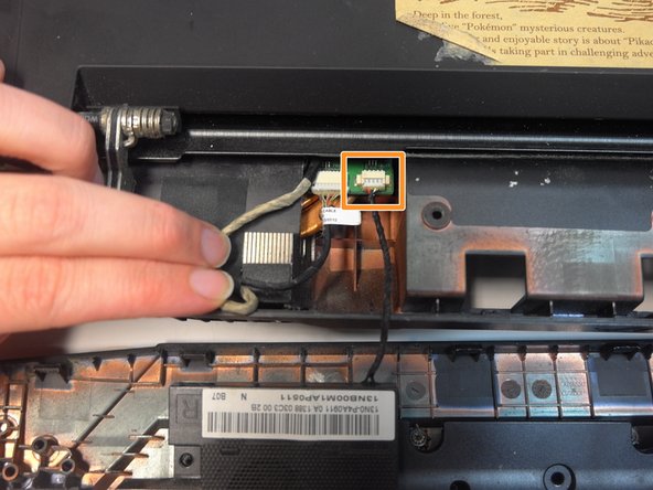

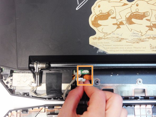

  6. Asus G750JW-BBI7N05 Left and Right Speaker Bar Replacement: crwdns2935265:06crwdnd2935265:01crwdnd2935265:03crwdne2935265:0 Asus G750JW-BBI7N05 Left and Right Speaker Bar Replacement: crwdns2935265:06crwdnd2935265:02crwdnd2935265:03crwdne2935265:0 Asus G750JW-BBI7N05 Left and Right Speaker Bar Replacement: crwdns2935265:06crwdnd2935265:03crwdnd2935265:03crwdne2935265:0
    • Without disconnecting the speaker cable, set the hinge cover upside-down.
    • Hold the speaker cable by its white connector, then pull to unplug it from the motherboard.
    • You may need to apply some force, as these connectors can be difficult to unplug.
