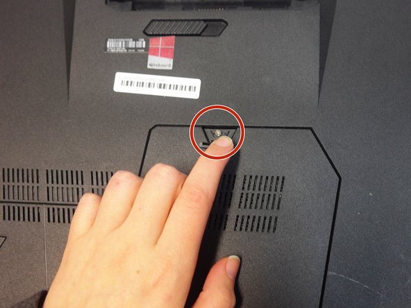

  4. Asus G750JW-BBI7N05 Hard Drive Replacement, Hard Drive: crwdns2935265:04crwdnd2935265:01crwdnd2935265:02crwdne2935265:0 Asus G750JW-BBI7N05 Hard Drive Replacement, Hard Drive: crwdns2935265:04crwdnd2935265:02crwdnd2935265:02crwdne2935265:0
    • Lift up the rubber stopper on the backplate to expose one Phillips #00 screw. Unscrew it until it becomes loose.
    • This screw is permanently connected to the backplate and cannot be removed. Unscrewing it only allows you to remove the lower case from the laptop.
    • The backpate is the plastic plate on the underside of the laptop that covers some of its easily accessible internal components.

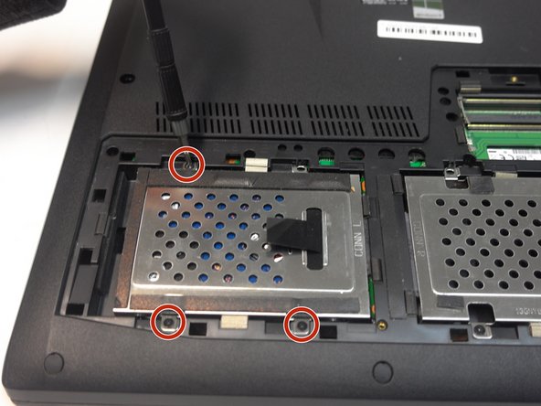

  6. Asus G750JW-BBI7N05 Hard Drive Replacement: crwdns2935265:06crwdnd2935265:01crwdnd2935265:02crwdne2935265:0 Asus G750JW-BBI7N05 Hard Drive Replacement: crwdns2935265:06crwdnd2935265:02crwdnd2935265:02crwdne2935265:0
    • On the left metal hard drive casing, unscrew and remove the indicated three 4mm Phillips #00 screws.
    • The right hard drive casing is for optional secondary hard drives.

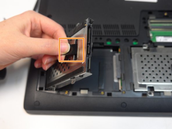

  7. Asus G750JW-BBI7N05 Hard Drive Replacement: crwdns2935265:07crwdnd2935265:01crwdnd2935265:02crwdne2935265:0 Asus G750JW-BBI7N05 Hard Drive Replacement: crwdns2935265:07crwdnd2935265:02crwdnd2935265:02crwdne2935265:0
    • Use the black tab as leverage to slide the metal hard drive casing all the way to the left.
    • Still holding the black tab, pull the hard drive casing up to remove it from the laptop.
  8. Asus G750JW-BBI7N05 Hard Drive Replacement: crwdns2935265:08crwdnd2935265:01crwdnd2935265:01crwdne2935265:0
    • Unscrew and remove the four 4mm Phillips #00 screws around the metal casing. Each side has two screws.
    • Slide the hard drive out of its metal casing.
