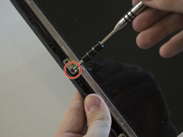

    6. Asus G74SX-BBK7 Screen Replacement: crwdns2935265:06crwdnd2935265:01crwdnd2935265:02crwdne2935265:0 Asus G74SX-BBK7 Screen Replacement: crwdns2935265:06crwdnd2935265:02crwdnd2935265:02crwdne2935265:0
      • Remove the two 6mm Phillips #0 screws on either side of the screen using a Phillips #0 screwdriver.
