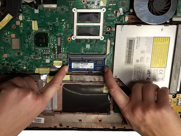

  5. Asus G73JW-XT1 RAM Replacement: crwdns2935265:05crwdnd2935265:01crwdnd2935265:02crwdne2935265:0 Asus G73JW-XT1 RAM Replacement: crwdns2935265:05crwdnd2935265:02crwdnd2935265:02crwdne2935265:0
    • Push the metal retaining arms away from RAM cards. One edge of the card should release and stick upwards at a 30 degree angle. Grab the free edge of the RAM card with your fingers and pull it free. Repeat this process with the following two cards.

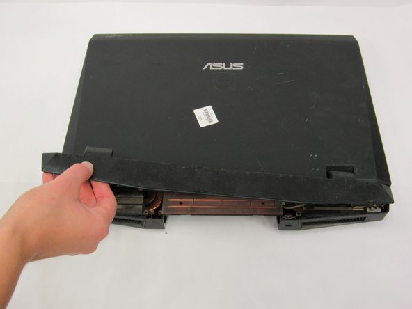

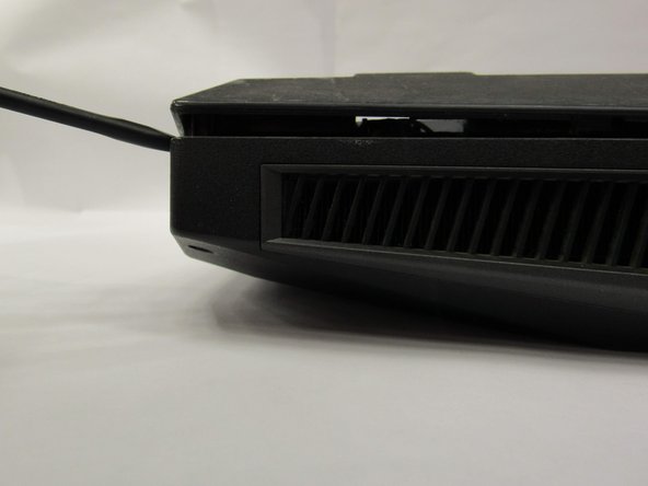

  8. Asus G73JW-XT1 RAM Replacement: crwdns2935265:08crwdnd2935265:01crwdnd2935265:03crwdne2935265:0 Asus G73JW-XT1 RAM Replacement: crwdns2935265:08crwdnd2935265:02crwdnd2935265:03crwdne2935265:0 Asus G73JW-XT1 RAM Replacement: crwdns2935265:08crwdnd2935265:03crwdnd2935265:03crwdne2935265:0
    • Flip the device over and turn it so the keyboard is facing away from you.
    • Insert the opener tool into the seam between the narrow plastic panel and the back panel.
    • Gently pry the narrow panel upward until it comes free. Lift the narrow panel away from the device using your fingers.

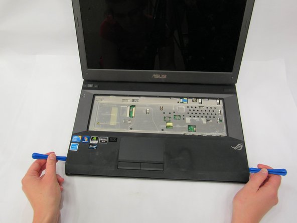

  10. Asus G73JW-XT1 RAM Replacement: crwdns2935265:010crwdnd2935265:01crwdnd2935265:03crwdne2935265:0 Asus G73JW-XT1 RAM Replacement: crwdns2935265:010crwdnd2935265:02crwdnd2935265:03crwdne2935265:0 Asus G73JW-XT1 RAM Replacement: crwdns2935265:010crwdnd2935265:03crwdnd2935265:03crwdne2935265:0
    • Rotate the device so the keyboard is facing you. Insert the plastic opening tool along the edge of the keyboard.
    • Working your way along the entire edge of the keyboard, gently pry the keyboard upward until it comes free.

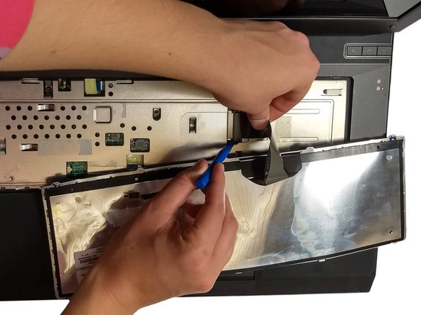

  11. Asus G73JW-XT1 RAM Replacement: crwdns2935265:011crwdnd2935265:01crwdnd2935265:02crwdne2935265:0 Asus G73JW-XT1 RAM Replacement: crwdns2935265:011crwdnd2935265:02crwdnd2935265:02crwdne2935265:0
    • Lift the keyboard partially away from from the device. A ribbon cable will still be connecting the keyboard to the device.
    • Using the plastic opening tool, slide the small clips on either side of the ribbon cable to the left. The ribbon cable should now be released.
    • Gently pull the ribbon cable and set the keyboard aside.

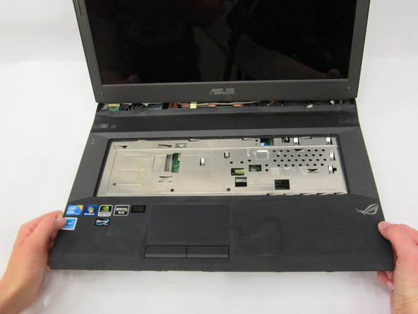

    • Insert the opener tool into the seam between the top and bottom panels. Using the plastic opening tool, gently pry the top panel upwards until it pops free. Repeat this process along the entire perimeter of the panel.
    • When the panel is free, grab the edge of the panel that is closest to you and pull it toward you.
