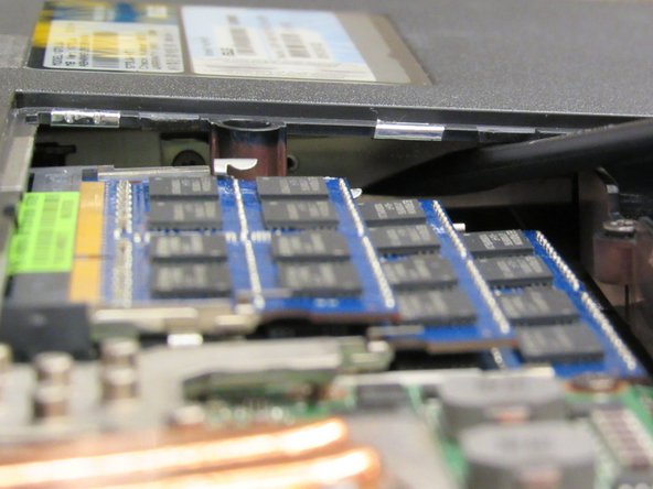

  5. Asus G73JW-XT1  Optical Drive Replacement: crwdns2935265:05crwdnd2935265:01crwdnd2935265:01crwdne2935265:0
    • Remove one 5.5 mm Phillips #0 screw directly to the right of the RAM cards.
  6. Asus G73JW-XT1  Optical Drive Replacement: crwdns2935265:06crwdnd2935265:01crwdnd2935265:02crwdne2935265:0 Asus G73JW-XT1  Optical Drive Replacement: crwdns2935265:06crwdnd2935265:02crwdnd2935265:02crwdne2935265:0
    • Insert the plastic opening tool in the gap between the motherboard and the back panel, directly to the right of the RAM cards.
    • Gently push the optical drive outwards. This should require very little pressure.
    • Grab the loose optical drive with your fingers and pull it free.
