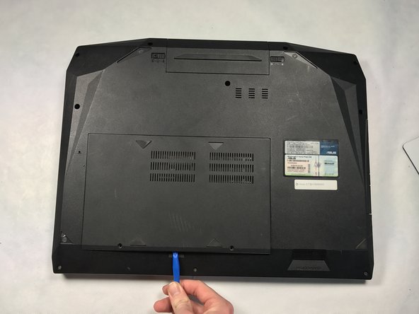

  5. Asus G73JH-RBBX05 Fan Replacement: crwdns2935265:05crwdnd2935265:01crwdnd2935265:01crwdne2935265:0
    • Using the PH0 screwdriver, remove the nine, 4mm screws on the bottom of the laptop.
    • You must remove the two, 4mm screws located under the battery. Remove the battery by following these steps: Asus G73JH-RBBX05 Battery Replacement
  6. Asus G73JH-RBBX05 Fan Replacement: crwdns2935265:06crwdnd2935265:01crwdnd2935265:01crwdne2935265:0
    • Using a metal spudger, remove the back cover of the laptop.
    • Apply constant force in order to unhinged the panel.

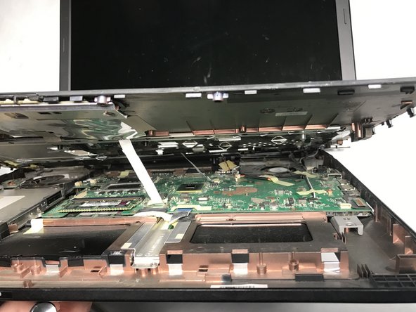

  8. Asus G73JH-RBBX05 Fan Replacement: crwdns2935265:08crwdnd2935265:01crwdnd2935265:02crwdne2935265:0 Asus G73JH-RBBX05 Fan Replacement: crwdns2935265:08crwdnd2935265:02crwdnd2935265:02crwdne2935265:0
    • Using a metal pry tool, remove the base cover
    • Once the cover is completely unhinged, don't forget to detach the strips connected to the motherboard.

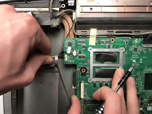

  9. Asus G73JH-RBBX05 Fan Replacement: crwdns2935265:09crwdnd2935265:01crwdnd2935265:03crwdne2935265:0 Asus G73JH-RBBX05 Fan Replacement: crwdns2935265:09crwdnd2935265:02crwdnd2935265:03crwdne2935265:0 Asus G73JH-RBBX05 Fan Replacement: crwdns2935265:09crwdnd2935265:03crwdnd2935265:03crwdne2935265:0
    • Locate the fan and remove the three 2mm screws with the PH0 screwdriver.
    • Before removing the fan, disconnect the cable.
