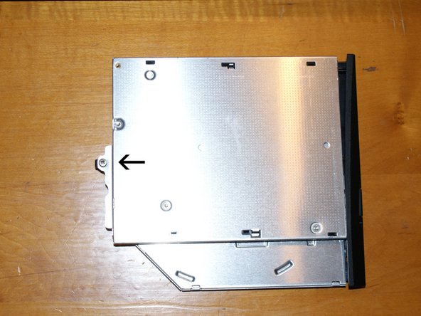

  5. Asus G73 Disassembly to apply GPU and CPU thermal paste: crwdns2935265:05crwdnd2935265:01crwdnd2935265:02crwdne2935265:0 Asus G73 Disassembly to apply GPU and CPU thermal paste: crwdns2935265:05crwdnd2935265:02crwdnd2935265:02crwdne2935265:0
    • Indicated by the white arrow is the screw to remove to allow you to pull the optical drive. Also visible beneath the screw hole is a silver tab. Push this to the right to get a grip on the drive door and pull it the rest of the way out. When the drive is removes, put the screw back in the hole in the drive, to keep track of it.
  6. Asus G73 Disassembly to apply GPU and CPU thermal paste: crwdns2935265:06crwdnd2935265:01crwdnd2935265:01crwdne2935265:0
    • With the optical drive removed, there are two screws now accessible, indicated by the black arrows. Remove them and set them aside, remembering where they go. If you like, make a post-it note of the location and tape the screws to the note.

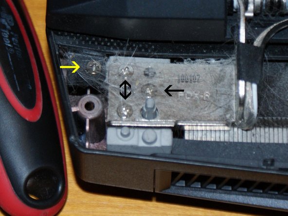

  12. Asus G73 Disassembly to apply GPU and CPU thermal paste: crwdns2935265:012crwdnd2935265:01crwdnd2935265:03crwdne2935265:0 Asus G73 Disassembly to apply GPU and CPU thermal paste: crwdns2935265:012crwdnd2935265:02crwdnd2935265:03crwdne2935265:0 Asus G73 Disassembly to apply GPU and CPU thermal paste: crwdns2935265:012crwdnd2935265:03crwdnd2935265:03crwdne2935265:0
    • The hinges exposed. To remove the cover, use either a small flathead screwdriver, or mroe ideally, a hard plastic spudger. Gentle pressure, and it should come right off.
    • Second image, close-up of the right hinge assembly. The black arrows point to the screw that secure the hinge to the bottom enclosure. The yellow arrow indicates a screw that hold the top cover on. Remove all four.
    • Third image. Same deal here for the left-hand hinge assembly. Three hinge screws and one top cover screw. The six hinge screws are longer than the rest used in the laptop, so they should be easy to keep separate. Remove these four as well.
