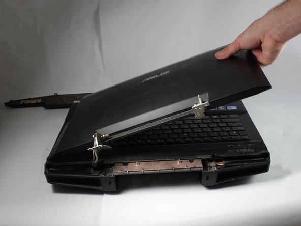

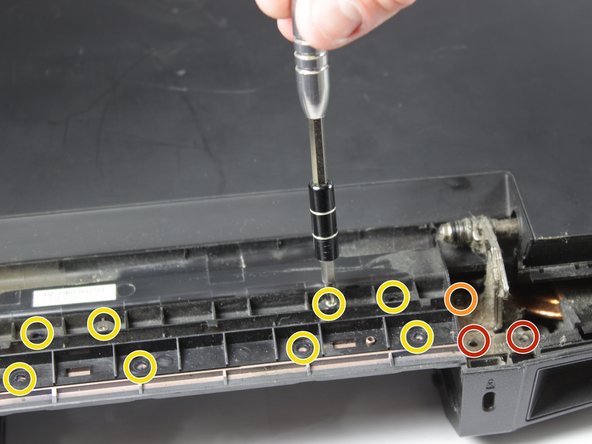

  15. Asus G53JW-A1 Screen Replacement: crwdns2935265:015crwdnd2935265:01crwdnd2935265:03crwdne2935265:0 Asus G53JW-A1 Screen Replacement: crwdns2935265:015crwdnd2935265:02crwdnd2935265:03crwdne2935265:0 Asus G53JW-A1 Screen Replacement: crwdns2935265:015crwdnd2935265:03crwdnd2935265:03crwdne2935265:0
    • Remove the four Phillips #0 M2.5x12 screws that hold the screen bracket in place.
    • Remove the two Phillips #0 M2.5x14 screws holding the screen bracket in place.
    • It helps to tilt the screen upwards for this step.
    • Remove the eight Phillips #00 M2.0x4.0 screws holding the cover plate in place.
    • Remove the cover plate and the screen.

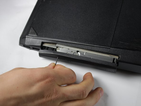

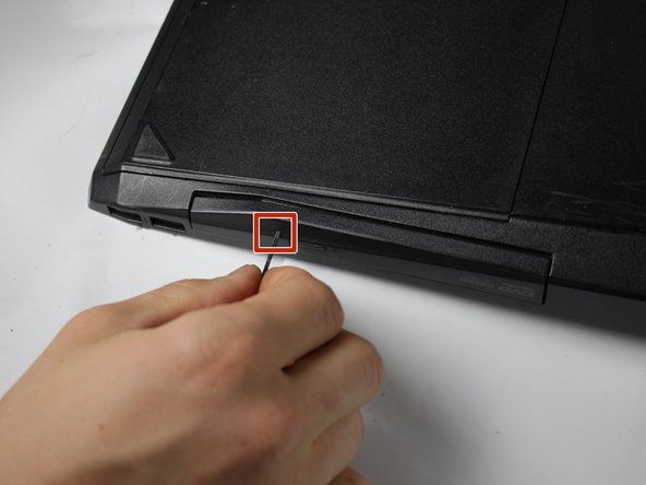

  17. Asus G53JW-A1 Screen Replacement: crwdns2935265:017crwdnd2935265:01crwdnd2935265:03crwdne2935265:0 Asus G53JW-A1 Screen Replacement: crwdns2935265:017crwdnd2935265:02crwdnd2935265:03crwdne2935265:0 Asus G53JW-A1 Screen Replacement: crwdns2935265:017crwdnd2935265:03crwdnd2935265:03crwdne2935265:0
    • With the laptop upside down, insert a paper clip into the small hole near the eject button on the CD/DVD drive.
    • If you don't have a paper clip, a similar-sized metal object will work.
    • You should not need to push very hard. Don't worry about breaking the drive - it is made to be opened this way when the computer is turned off.

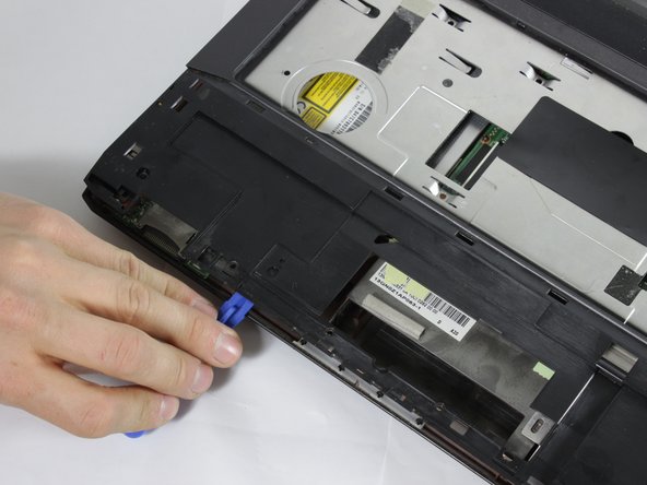

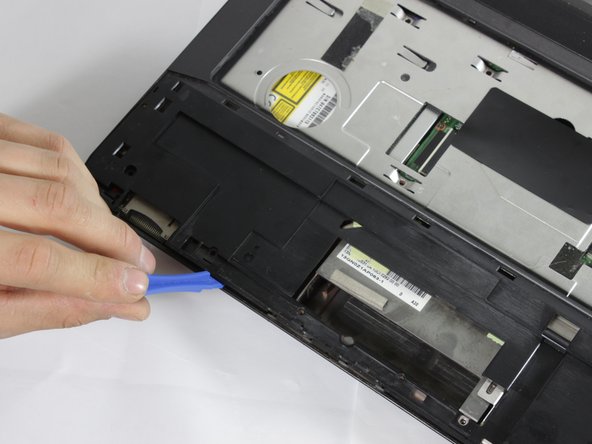

  20. Asus G53JW-A1 Screen Replacement: crwdns2935265:020crwdnd2935265:01crwdnd2935265:03crwdne2935265:0 Asus G53JW-A1 Screen Replacement: crwdns2935265:020crwdnd2935265:02crwdnd2935265:03crwdne2935265:0 Asus G53JW-A1 Screen Replacement: crwdns2935265:020crwdnd2935265:03crwdnd2935265:03crwdne2935265:0
    • Turn the laptop over so that the keyboard side faces upward.
    • Use a plastic opening tool to pry the large plastic plate off of the body of the computer.
